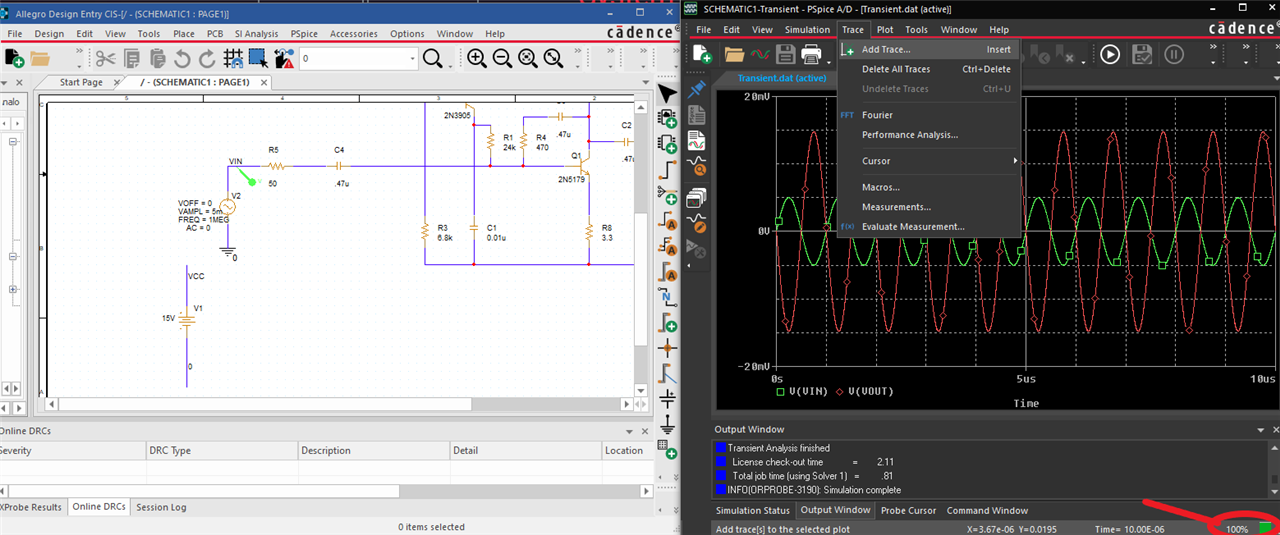

Hi there,
I practicing this project for AC sweep, https://www.ema-eda.com/courses/pspice-22-1-walk-through/lessons/lesson-11-ac-sweep/
After the PSpice >Run , the simulation continues but I can not see the Add trace tab, here
What's the wrong I am doing.
Should I not use "VSIN" because  its not an AC source, it's a sine wave voltage source.
It works if I use  part "VAC" (although you can still use "VSIN" but add AC=1 in the
selections).
Kindly let me know.
Hasan

    HIMS over 1 year ago in reply to HASAN2024 +2 verified
    It looks like your simulation data wasn't created due to missing AC value - this is set by property AC for AC sweep - This is also done in the video link you are referring. The property AC=1 will inject…

    Once 100% simulation is completed, it will show Add Trace option in PSpice probe window menu.
    I tried running simulation for the design in reference and simulation got completed 100% without any issue and Add Trace option is also visible.

    rg13  I don't know what happened in my simulation file but it only works if i do  AC=1 and avoid VSIN.
    The property AC=1 will inject an AC pulse with frequency being swept as defined in AC sweep simulation settings.
    Without AC property, the simulation output should have given a warning like below.
