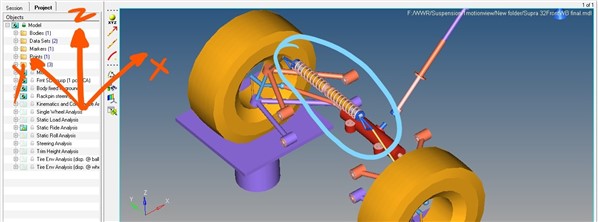

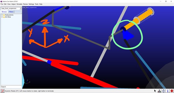

As shown below in the first picture the bellcrank in the chassis is in the
x-z plane, but I needed the bellcrank to be located in the y-z plane, having the dampers making a "V" shape like below in the second image.
Problem
It would be great if someone could help me out in pivoting the bellcrank
to the y-z plane and have the dampers making a "V" shape.

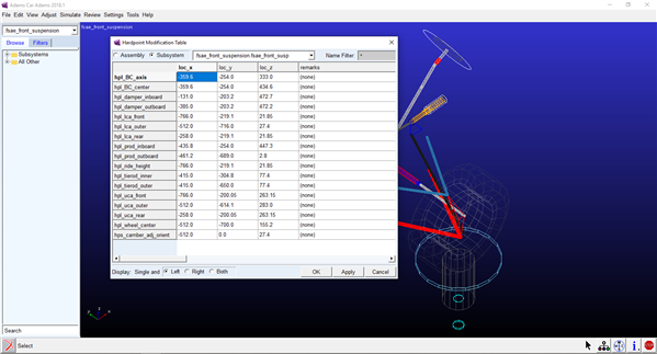

For reference, i am attaching the Picture of hard point adjustment table
Screenshot (14)
Thanks in advance.

    Yes, it is exactly the hardpoint that you have highlighted in your picture. The pivot axis of the bellcrank will point from hpl_BC_center to hpl_BC_axis.
  • rahul.alex
    0 rahul.alex over 7 years ago
    Thanks JSlatten for the help, just wanted to ask about how do you adjust the values in the table? Do you just do it by a hit and trial method or is there a hidden technique/procedure behind it?
  • Jesper Slattengren
    0 Jesper Slattengren over 7 years ago
    Well, in most cases you would get data from a CAD model. But in your case it is trivial.
    Use hpl_BC_center+{100,0,0} and the bellcrank will be oriented in the YZ plane. The distance is not important, only the orientation of the vector from hpl_BC_center to hpl_BC_axis
