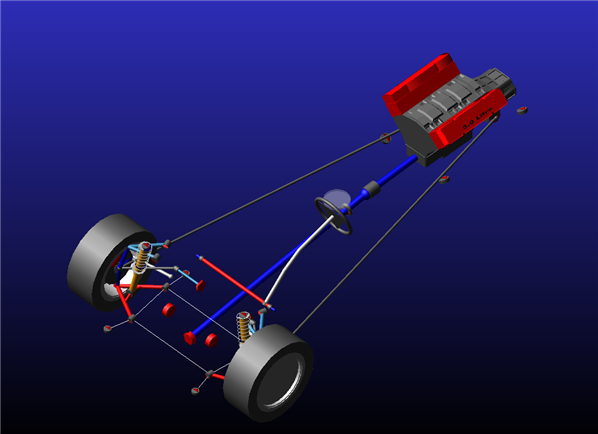

    Yes now you got my point.
    Did you ever tried that?
    I have tried in above mention way but i am not getting proper results.....
    Capture18
    I am getting some thing like this!!!
  • m.derbas
    0 m.derbas over 7 years ago
    It actually Looks not so bad, not being ironic
    What you Need to do still is to Change the Name of the Communicators and also role
    to Elaborate more: you only have one powertrain and you cannot create two Communicators with the exact same Name in one template, therefor you Need to create the Output Communicator co[rl]_tripot_to_differential_front with a front role obviously and then modify the existing Communicator for the tripot to co[rl]_tripot_to_differential_rear (don't Forget to also Change the matching Name by adding _rear to it)
    Then I think you Need to modify the existing Communicators in the double wishbone templates to match your powertrain Communicators (i.e the front and rear role as well)
    To save time, always use the test Communicators function to make sure you don't waste time on opening and Assembling parts
    best of luck !

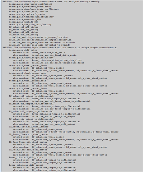

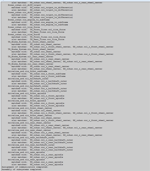

  • rohan.tiwari
    0 rohan.tiwari over 7 years ago
    Firstly, thank you so much for your help, It means a lot to me. If possible for you can you please check these screenshots, this is what I am getting after generating the assembly. So that I can improve my results!!!
    mail8
    mail7
  • m.derbas
    ​That is a lot of Communicator missmatches.
    As I said don't waste your time on checking without making sure you have some Progress, write down on a Piece of paper the Communicators you have to do and then check one after the other, only write a check if the Communicators are matched in a test (to do that, in template mode: build, Communicators, test)
    this will be take some time but you will get it right
