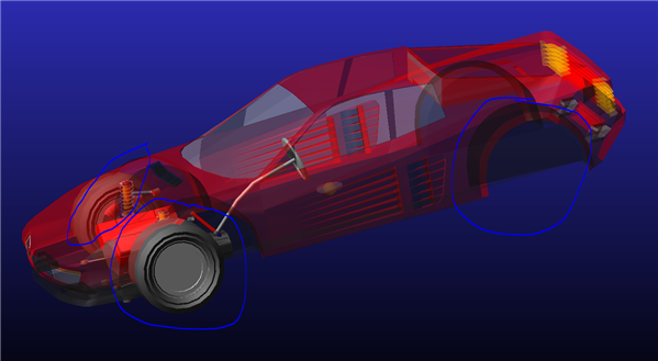

    Hello Derbas, The older task was getting little complicated, So I have started with the simple task by making the demo vehicle into a front wheel drive because it uses the same template for the suspensions subsystem. And I was able to connect all the connections. But now the problem is rear tire and rear suspension both are colliding with the front tire and suspension. I hope you can help me with this.
  • m.derbas
    0 m.derbas over 7 years ago
    ​They aren't really colliding, from the Looks of it they are completely overlapping from the beginning ?
    In Standard Mode, open the following Subsystems:
    YOUR: Front and rear tires and suspension
    Shared: Front and rear tires and Suspension
    Under adjust, hardpoints, table you will find the coordinates of all the hardpoints
    Copy from the shared subystems into your Subsystems and click apply, the components should be then positioned correctly
    P.S: If an error occurs, make sure that the copying process didn't add spaces after every value on the last column (Z Values). If so then delete them and press apply again !
    Best of luck !

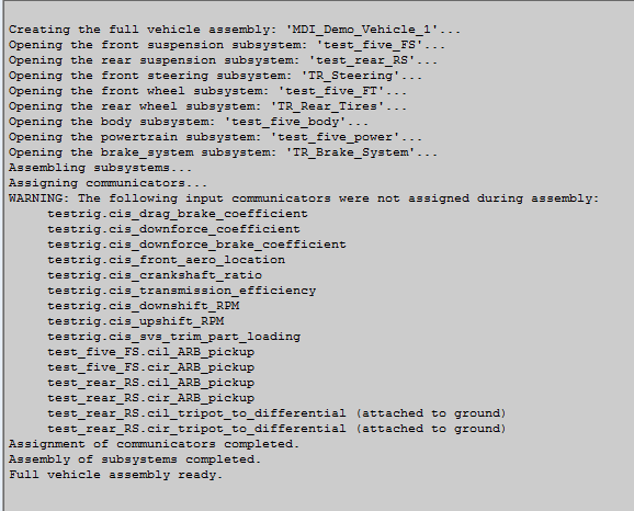

    Hello, thank you for your reply.
    that worked perfectly, but i don't know why it is not simulating,
    i am getting this error-
    FUNCTION : VAR1251
    PROBLEMS GETTING TIRE PARAMETER
    VARIABLE ID : 7
    TIRE ID : 1
    ** STOPPING ADAMS SOLVER **
    Static Solution converged in 7 iterations
    Residual imbalance is less than 6.10733E-08
    End Static Solution
    Simulate status=0

  • m.derbas
    As it clearly says, something is wrong with the tires
    Check them out​, re-assign to them a .tir file
    If that doesn't work, run the Simulation in the Event builder rather than other places.
    If you deactivate the static solution there and give it proper Parameters, it will maybe at least simulate the first steps
