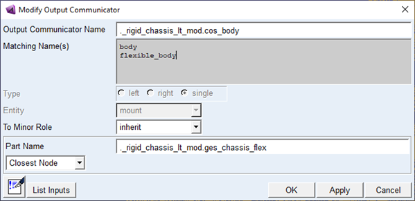

    So i modified rigid_chassis_lt, replaced rigid chassis with flexible one (i used mnf from concept database), move flex part to location -1275.0, 0.0, -220.0
    what is needed after modification, you have to modify cos_body communicator and add there matching name: flexible_body
    Capture
    Capture
    in attachment you have my template from Adams 2018 based on rigid_chassis_lt

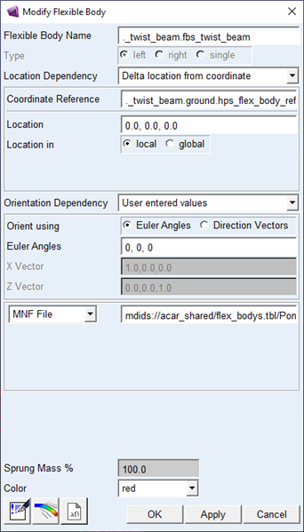

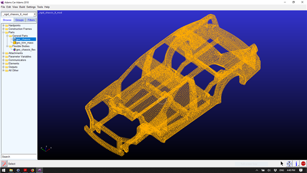

    Also i have noticed few strange this (maybe bug), maybe just my lack of knowledge. For flexible body in template builder i was using right click in tree on rigid part/ make flexible, then import mnf.
    What i do not understand: flexible part is still ges not fbs as it should be:
    Capture

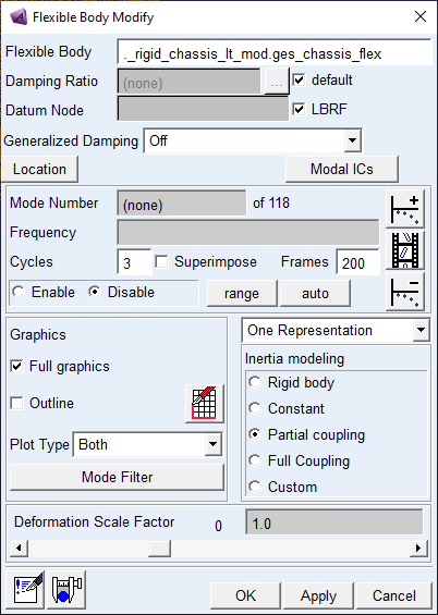

    Also if i right click on this part and use modify. Then Adams uses this window:
    Capture
    not this one as usually:
    Capture

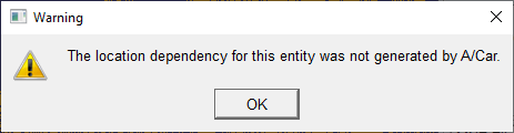

    If i use build/parts/flexible body/modify
    then after selecting flexible body which i want to modify, there is warning about:
    Capture
    and then Adams Car always crash

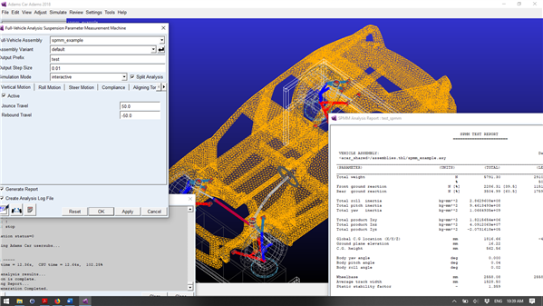

    I got a chassis template that runs properly with a rigid chassis (see F98_spmm_rigid_chassis_01_spmm.msg). One hickup is the aero geforce has to be manually deactivated. That's a secondary issue as to why the aero gforce is not being deactivated by the submission macro:mac_ana_ful_spm_sub.
    The trouble is when I import an MNF for the ges_chassis body, and submit an SPMM analysis
    The trouble happens after the static equilibrium solution completes and the Quasi-Static starts and fails to converge.
    I've tested replacing the ges_chassis with the flexbody on the SDI testrig without a problem. Straight line, cornering, and full course simulations run fine.
    The issue is probably some joint or entity being activated/deactivated between the SVC suspension setup analysis and the Quasi static analysis. What ever is happening there is the problem.

    I've been switching the rigid-body to a flex-body by "modify general part" dialog box. There is a bottom for "Rigid to Flex". That brings up the "Swap a rigid for a Flexbody" dialog box. The "ges_chassis" body gets renamed to "ges_chassis_flex". A warning does come up that comminicator information is not saved in the subsystem. Afterwards the import "modify general part" dialog box looks the same except the "flexbody body modify" icon is now available. I've not had a problem opening and closing the "flexbody body modify" dialog box.
