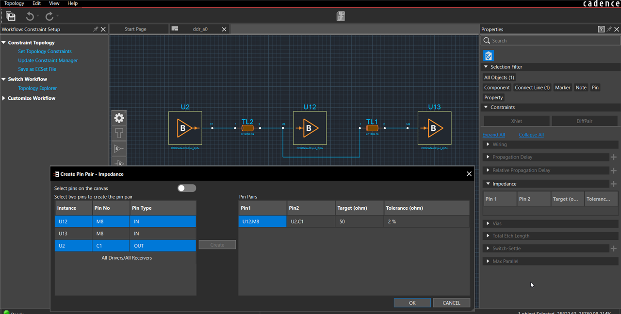

I am in the middle of learning Sigrity Aurora through an online course and have come across a problem which has brought me to a halt. I am trying to add constraints to an ECSET but it is greyed out.
I am clicking setup>constraints>electrical, right clicking on the net and select Explore Topology which then opens the topology explorer, select the ECSet tab, click Set Topology Constraints, click the green + symbol beside Impedance and when the Create Pin Pair - Impedance window opens it's greyed out.
Any ideas or help on what is causing this and more importantly how to get this sorted is much appreciated.

    Hi Don,
    May I know which Aurora version you're using? You can check the version by selecting Help>About from menu.
    In 'Create Pin Paid- Impedance' window, you need to select the pin pairs by using ctrl button from the list of components and click 'Create' to add them as a diff pair. Next, add Target Impedance and Tolerance values.
    Is this what you're trying to achieve?

    Hi Shiva, thanks for the reply,
    I am using v23.1. I can see the same window you have in your image but the problem is I cannot select anything as the window is greyed out and things can not be selected. I thought it could be a lock file causing this but I have deleted any lock files I could find and then try again with restarting the software but still having the same issue. I will go back and see if I'm doing anything wrong since I'm in the middle of learning about Sigrity Aurora. If you have any other suggestions to try would be great,

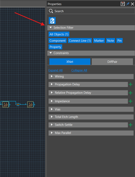

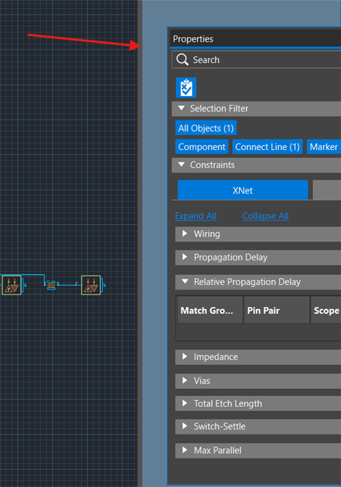

    Don2009 Make sure you dock the Properties/CM window. Once you dock the window, you should be able to add/edit constraints.
    This should resolve the issue.

    0 Don2009 11 months ago in reply to geda
    Thanks for the message Geda. I tried the design on v22.1 and it works fine but in v23.1 it is greyed out but I will try your suggestion to see if it works.
