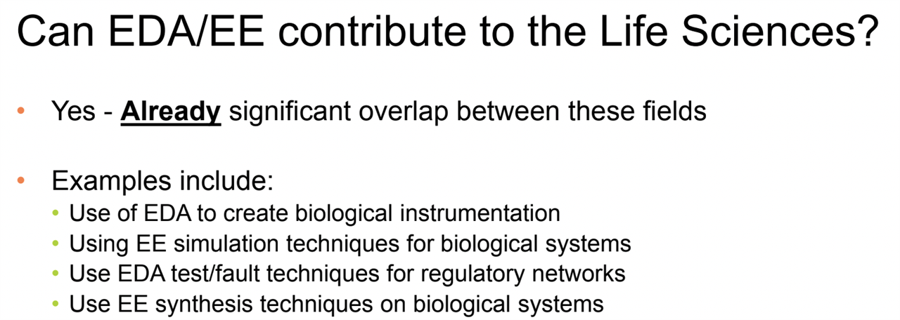

can eda/ee contribute to life sciences
Lou went first and pointed out that EDA already contributes to life sciences.
rent's ruleOne example is Rent's rule (which relates the number of I/Os required for a block containing a given number of computing elements). In both cases, EDA and biology, 0.5 to 0.7th power of the number of "gates" gives the number of "pins." He then listed several papers that connect EDA algorithms to life science.
