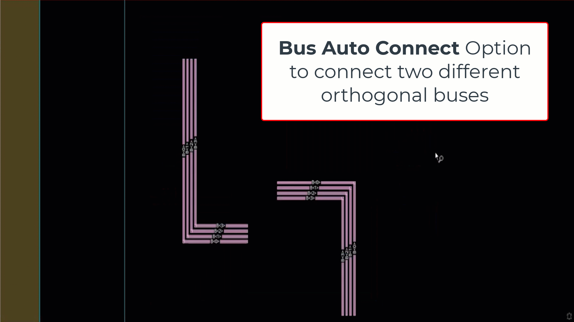

1. Turbocharge Your Routing with the Turbo Bus Toolbar
Meet your new routing powerhouse: the Turbo Bus Toolbar. This all-in-one interface consolidates key bus routing tools—like Auto Connect, Create/Edit Bus, Tunnel, Chop, and Chamfer—into a streamlined workflow. With DRC-aware routing, multilayer support, and high-speed algorithms, it’s built for scale and speed.
Perfect for handling hundreds of connections with precision and ease.
Here is the information on the toolbar icons, and here is the demo on using the toolbar.

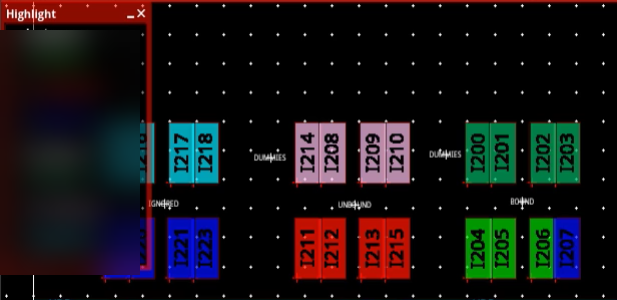

3. Visualize Binding Like Never Before with Bind Color Map
Say goodbye to guesswork! The Bind Color Map feature uses intuitive color coding to show which instances are bound, unbound, or ignored, right in your schematic and layout views. With adjustable transparency and line thickness, this tool makes the design status crystal clear.
A must-watch for anyone who wants instant visual feedback on binding.
