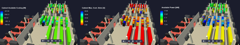

Image and relative results of capacity availability for a data center in operations—considering cooling, space, and power—generated using Cadence Reality DC Digital Twin
