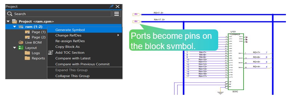

Method 1: Create a Hierarchical Block from an Existing Schematic
This method is ideal when you already have a schematic and want to reuse it as a hierarchical block. To create a block from an existing schematic:
  1. Open the existing schematic.
  2. Right‑click the existing schematic in the Project Explorer and choose Generate Symbol.
    The ports in the schematic automatically become pins on the block symbol.
  3. Choose File - Import - Block(s) to place the block in another schematic.
    The block symbol is created directly from the schematic, preserving ports and connectivity—no manual cleanup required.

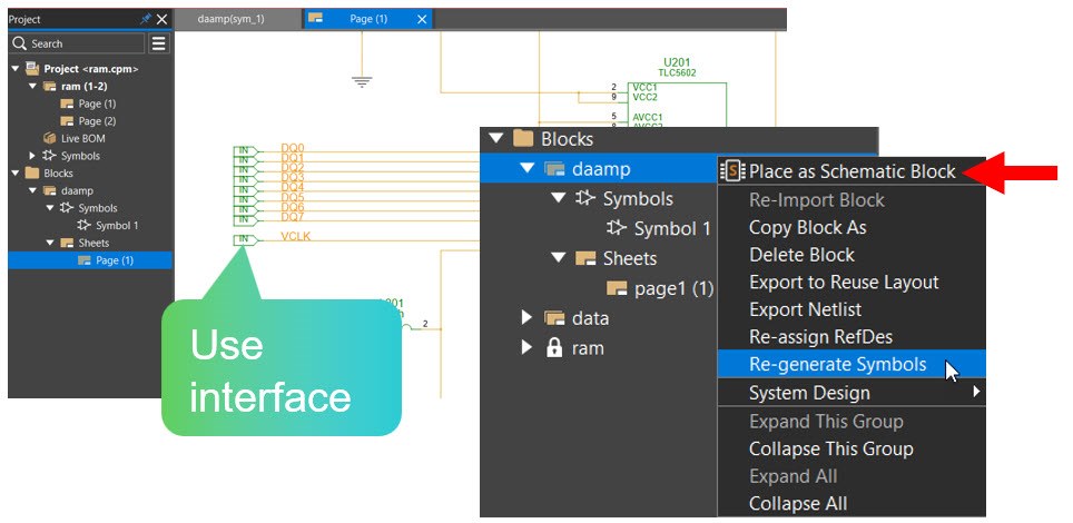

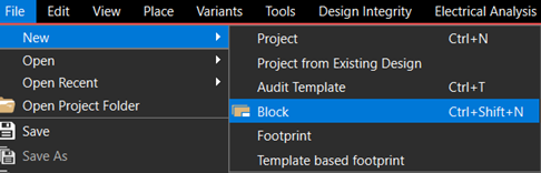

Method 2: Create a New Hierarchical Block
When you want to define the block structure first and then build the circuitry inside it, use this method. To create a new block:
  1. Choose File – New – Block.
  2. Specify the block name.
  3. Open the new block sheet and add your circuit.
  4. Add port symbols to define interfaces.
  5. To regenerate the block symbol, right-click the block and choose Re-generate Symbols.
  6. To place a block in a schematic page, right‑click on Block and choose Place as Schematic Block.
    This approach allows design teams to define the system structure early and refine each block incrementally, making it ideal for collaborative and evolving designs.
