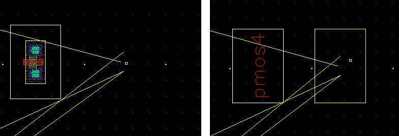

In Layout (I'm using 6.1.3.500.13) , there are these bindkeys Shift-F and Ctrl-F to show/hide the contents of instances in the layout. Now when I drag an instance around, the contents of the instance disappear. In "hide contents mode" (Ctrl-F) an outline of the cell is shown, but in "show contents mode" (Shift-F) the entire cell disappears and you're basically moving an invisible ghost with flight lines. Needless to say this is cumbersome when you want to move instances with any degree of accuracy.
This doesn't happen with polygons on the current level of hierarchy; these always remain visible while dragging. Is there a way to make this happen with instances as well?

    I've included a screenshot just to make sure we're talking about the same thing. On the left I'm dragging an instance after Shift-F, on the right after Ctrl-F (click to see the whole picture).

     It looks very much as though you're using the austriamicrosystems hitkit 4.00 for one of their 0.35um processes. I have exactly the same problem. You'll notice that this is a problem that only affects their pcells, it's not all instances that have the problem.
    With IC 6.1.3.1 everything worked fine.
    I imagine that we need to wait for an update from AMS themselves.

  • skillUser
    skillUser over 16 years ago
     Hi All,
    I just wanted to let you all know that this is due to the tools themselves and not any particular PDK etc.  Basically when performing a Move, anything more than 1 level down in the layout hierarchy does not display detail, just a box or outline.  R&D are working to try to improve the display detail during a Move operation, hopefully in ISR2 of IC614. The amount of code changes required means that additional testing and stability checks are needed before releasing.  Master CCR is 500889.

  • archive
    archive over 16 years ago
     Further details I've been told:
    "The problem occurs when the design library is attached to one tech library, but the instances used in the layout of the design library are attached to another tech library."
     So in the AMS case, your library is probably attached to TECH_C35B4, whereas the instances from PRIMLIB are attached to TECH_C35B3.
  • vader
    vader over 16 years ago
     Alex, Lawrence,
    I think you have misunderstood the original poster's question. Looks to me when he moves, not only is the content not showing, the bbox is not showing either. He only sees flight lines.
    This is VLS XL right?
    Teng-Kiat
  • Grover
    Grover over 16 years ago
    Yes, almost. The BBox is shown only in "don't-show-contents" mode (the right half of the picture).
    And yes, I'm using Layout XL.
