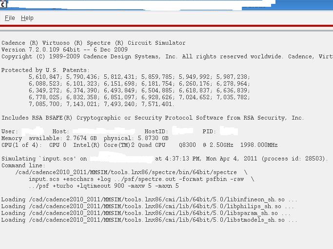

Hello all,
When i'm trying to simulate my circuits with Spectre it sticks for a couple of minutes after the last four lines of the image i upload and then continues and finishes successfully the simulation.The problem is that it costs me a lot of time to wait for repeating simulations and i need a solution for this.
I am using the following versions :
Virtuoso sub-version  IC6.1.4-64b.500.6
SPECTRE sub-version  7.2.0.109
CentOS 5.5 64-bit
I should note that the problem exists for older versions of Virtuoso (e.g. : IC6.1.3) as well.In addition i am using the option "Turbo" under High-Performance Simulation menu of ADE L and i am saving the results of the simulations locally,that is in a directory of the local hard-disk and not at the hard-disk of the server that cadence is installed (we use a unique installation of Cadence in our lab and we use NFS to share it with all other workstations and the users are loaded via NIS/Yellow Pages).
If you need more info to come to a conclusion ask me to provide it.
Thanks a lot in advance.
Best Regards,
Jimito13

    Hi Jimito13
    I suspect that this problem will not happen when spectre is run in a terminal window. Would you please go to the simulation directory and execute the "runSimulation" file? Does it still show the delay?
    In the spectre log file which was ran from ADE, are there any messages about licensing? E.g. retry for license, etc.
    Thanks

    Hi Quek,
    I found the file you suggested me but i don't know how to execute it in a terminal...do you mean to run it in a way outside the GUI of ADE L?Please guide me if possible.
    The spectre log file is clear concerning licensing issues.I also check the CIW messages and i have no warnings or errors.
    Any other idea?This is a damn problem,it came up suddenly without doing anything in cadence installation or in my profile and as you can understand it costs time...

    Hi Jimito13
    You can use "runSimulation" as follows:
    terminal>cd /your-path/netlist
    terminal>./runSimulation
    OR
    terminal>spectre -turbo ./input.scs
    Best regards
