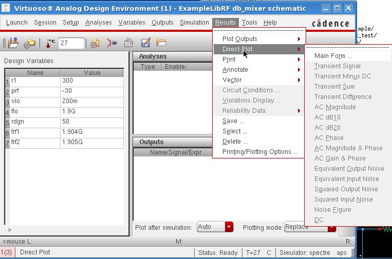

    I just happen to have IC615 open right now and going to start running spectreRF simulations.  (I hope the screen shot comes through and isn't filtered out.  I have included it below).
    I have selected from the Simulation window:  Results->Direct Plot->Main Form .  The entry is not greyed out. If you are able to see the Direct Plot form, depending on the simulation that you run (e.g. tran, ac, sp, hb, etc), you will see different options in the Direct Plot form when it appears on your monitor.

    Maybe you have some obsolete menus files providing customization for an earlier release, and as such these have stopped the Direct Plot main form menu from appearing?
    Try doing (at the UNIX prompt, with the same setup environment you're using):
    cdswhich menus
    If it finds something, maybe you have an old spectre.menus or simui.menus file within this directory. If so, try moving the menus directory aside (or see if there's a UNIX env var which is causing that to be found via the "setup.loc" or Cadence Search File mechanism and unset it), and see if that fixes your problem.
