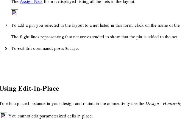

I am using IC5141 hotfix and cdsdoc version is 2.1. I don’t have any problem to open cdsdoc in Mozilla but I am not able to view any of the images and also I am not able to go down to any of the link which are usually given in documents. Images in document looks like broken one which is as shown in pic (It is attached to this post). Whenever I am trying to open any link, it throws some warning saying
“The connection was refused when attempting to contact vlsi60:9000.”
And then it never opens. How can I resolve this? Any kind of suggestion would be appreciated.

    Hi Vinay,
    You should not need that solution if running on RHEL4. Can you try doing:
    cdsdoc -test
    which cdsdoc
    also try these steps:
    If CDSDoc is running, shut it down by clicking Exit in the Library window.
    Make sure old CDSDoc processes are not running:
    • Use the ps -ef command to look for the processes obServer and https. If they are running, use the kill command to terminate them.
    Set the debug environment variable in a shell window (UNIX) or command prompt (Windows).
    •  setenv CDS_DEBUG_CDSDOC "debug"
    Restart CDSDoc . Go through the steps of opening a document, and then post the debug output that appears in the terminal window.

    I set CDS_DEBUG_CDSDOC variable. When i typed "cdsdoc -test " it returned as
    CDSDoc is no longer available. It has been superseded by Cadence Help. Type 'cdnshelp' to access the help system.
    So i typed cdnshelp -test but it gave as
    Unknown option: test
    Cadence Help v01.11-p014
    Copyright (c) 2006-2008 Cadence Design Systems, Inc. All rights reserved
    Launching gui.../cad/cadence/IUS82/tools.lnx86/cdnshelp/bin/cdnshelp.exe /cad/cadence/IUS82/doc/xmlreg/library.lbr   Debug Mode: Logging is on.
    cdnshelp opened but opened documents are only for IUS8.2. Hence i tried to open cdsdoc from the cadence installation directory & typed  "<installation_dir>/tools.lnx86/bin/cdsdoc -test " which gave result as
      CDSDoc 2.1 Installation verification
    Check system - Linux vlsi60 2.6.9-22.ELsmp #1 SMP Mon Sep 19 18:00:54 EDT 2005 x86_64 x86_64 x86_64 GNU/Linux
    Checking installation directory... Done.
    Checking user environment variables... Done.
        Status: Cadence CDS_DEBUG_CDSDOC environment variable is set to -
                debug
    Checking Netscape, make sure Netscape 4.51 (or higher) is in your PATH ...
              --- Warning: Netscape NOT found ---
    Checking Directory Structure...
    Directory Structure Check passed
    Done.
     Then i started icfb, and went to 'help' for openening cadence document.CDSDOC opened and in terminal the following message appeared.
    CDSDoc API 2.1, Cadence Design Systems, Inc.
    obApi: cdsdocInt02.10-s001 06/22/04 10:06 pubtools itglinux
    obApi: install dir = /cad/cadence/IC514H
    obApi: install dir (for docs) = /cad/cadence/IC514H
    obApi: Project: NULL
    obApi: Using default server: dir=/cad/cadence/IC514H version=v2.1
    obApi: mpssession=localhost:vinay_rao mpsversion=v2.1
    obApi: Server is active
    obApi: Calling server to show Tag: command_interpreter hiNoHelp  0 /cad/cadence/IC514H
    obApi: Result of server call: handle=0 status=3
    obApi: Calling server to show Tag: dfii hiNoHelp  0 /cad/cadence/IC514H
    obApi: Result of server call: handle=-2 status=0
    For "whichcdsdoc" it gave as
    /cad/cadence/IUS82/tools/bin/cdsdoc
    In addition, i found no CDSDOC processes are running (In actual i didn't understand clearly how to check for it but neither cdsdoc nor http/observer is visible in in ps -ef ).

    Try making sure that the <IC5141> paths are before your IUS paths so that cdsdoc is found from there, and repeat the tests. Because cdsdoc has been retired, only old releases (such as cdsdoc) still have it.

     I kept IC5141 before IUS paths and ran those tests again. Outputs are as follows.
     $ cdsdoc -test
    Check system - Linux vlsi60 2.6.9-22.ELsmp #1 SMP Mon Sep 19 18:00:54 EDT 2005 x 86_64 x86_64 x86_64 GNU/Linux
    Done.
    $ which cdsdoc
    /cad/cadence/IC514H/tools/bin/cdsdoc
    In  ps -ef i found 3 suspect runs.
    /cad/cadence/IC514H/tools/bin/cdsMsgServer -mpssession i
     cdsServIpc -c 40987 -n 0 -r 10 -x /cad/cadence/IC514H/to
     cdsServIpc -c 40987 -n 1 -r 10 -x /cad/cadence/IC514H/to
    Whether these are also have to be killed? Other than these 3, i didn't find any.
    Then i opened cdsdoc in terminal and tried to open some documents, it gave as
    CDSDoc, version 2.1
    Copyright ￿ 2000-2003, Cadence Design Systems, Inc.
    library: Reading hierarchy: /cad/cadence/IC514H
    obApi: Calling server to open document: /cad/cadence/IC514H/doc/vlehelp/chap4.html  0 /cad/cadence/IC514H
    obApi: Result of server call: handle=-2 status=21
