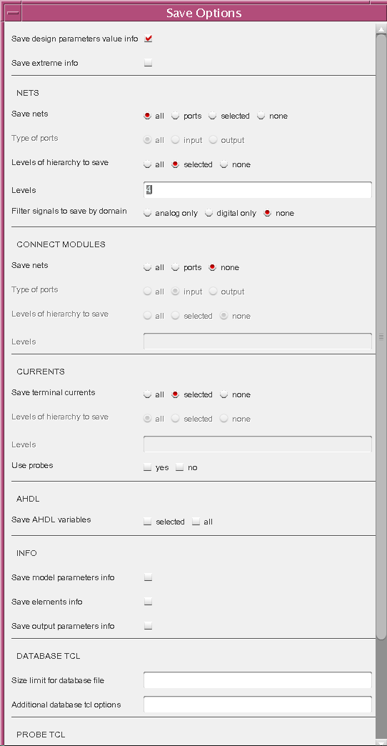

I'm using AMS simulation thru ADE L in IC615.500.10 and want to enable psfxl format as transient output which is claimed to be supported. But I don't found any check box or selection in Outputs - Save All form.
Anyone knows how to enable psfxl? Thanks!

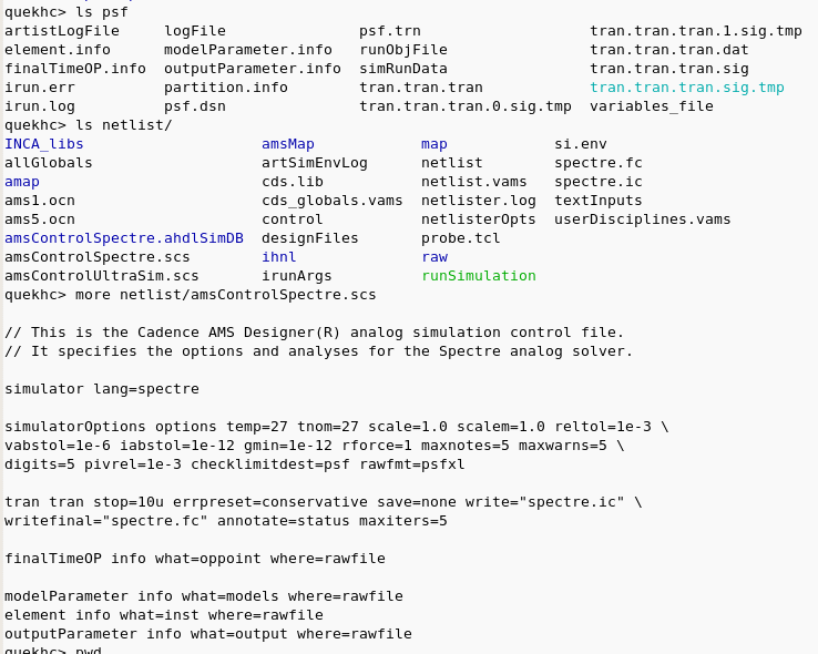

  • Quek
    Quek over 13 years ago
    Hi greatqs
    You can ignore the warning. It should actually be an info message and not warning. I just tested it using ncsim 11.10-s058 and IC615-500-12 and can successfully generate a tran.tran.tran file in the "psf" results directory. Would you please check again to see if you have made any mistakes in the setup?
    Thanks
    Quek
