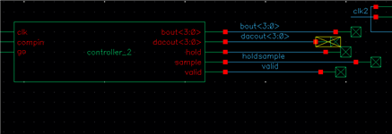

    But I have one another question, as I am designing sar adc and I have two bus pin name dacout<3:0> and bout<3:0> respectively. So noConn is not accepting the same instance name so can you please suggest to me what exactly I can do in this case? I am attaching here snapshot so it will be more clear.
    Andrew Beckett over 7 years ago in reply to Savankuamar
    Well, clearly you can't give two instances the same name, so give them different names. For example NOC1<3:0> and NOC2<3:0> or NOCdacout<3:0> and NOCbout<3:0>. There's nothing special about the instance name having "NOC" in it - you just need to make it a vectored name which has the same width as the bus to which it's connecting.
