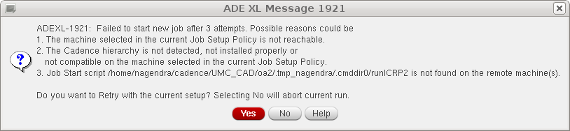

I am getting ADEXL1921 error (image attached) when I try to start Monte Carlo(or any other simulation on ADEXL) on IC6.16. I know Debian isn't officially supported, but would appreciate any help if others have figured it out. I saw some related posts and tried those things, but didn't work.
(OS: Debian GNU/Linux 6.0.8 (squeeze) 2.6.32-5-amd64; Sub version:         sub-version  IC6.1.6.500.1  (32-bit addresses) )
Running "runICRP*" manually didn't do anything (didn't produce any output on the command line). I removed the >/dev/null from the last line and tried and it made no difference. Also tried running it line by line. Not sure what running cdsVncserver should do, but again, nothing (apparent) happened. I also went through the links below which mentioned the same problem.
www.cadence.com/.../20678.aspx
This suggests that libgdbm.so maybe missing, but in my case it is present in /usr/lib as well as linked to in IC616 hierarchy
groups.google.com/.../
Using no cdsinit didn't change things. Also, the job monitor shows nothing.
support.cadence.com/.../
This mentions that the Xndx related problem is only relevant for IC613 or earlier

    The problem seems to be that cdsVncserver doesn't start. On another (CentOS) machine, where ADEXL simulations do run, invoking cdsVncserver starts a cdsXvnc process. On the Debian machine mentioned above, it doesn't. I did some basic things like fixing font paths so that it can find it(based on errors reported in strace), but wasn't able to get cdsXvnc started by doing cdsVncserver :80.
     Command line output (psg is short for ps -aef). Looks like the script starts to run, but dies on the way.
    n~> 62: cdsVncserver :80
    n~> 63: psg cds | grep -i vnc
    n 26147     1  0 16:34 ?        00:00:00 perl /cad/tools/cadencetools/IC-614.06.14.510/tools/bin/cdsVncserver :80
    n~> 64: psg cds | grep -i vnc
    n~> 65: psg cds | grep -i vnc
    Exit 1
    n~> 66:
    Running cdsXvnc Something seems to be happening.
    n~> 66: cdsXvnc :80
    09/05/14 16:36:03 Xvnc version 3.3.7 - built May 31 2004 15:31:52
    09/05/14 16:36:03 Copyright (C) 2002-2003 RealVNC Ltd.
    09/05/14 16:36:03 Copyright (C) 1994-2000 AT&T Laboratories Cambridge.
    09/05/14 16:36:03 All Rights Reserved.
    09/05/14 16:36:03 See http://www.realvnc.com for information on VNC
    09/05/14 16:36:03 Desktop name 'x11' (orion:80)
    09/05/14 16:36:03 Protocol version supported 3.3
    09/05/14 16:36:03 Listening for VNC connections on TCP port 5980
    Font directory '/usr/X11R6/lib/X11/fonts/Speedo/' not found - ignoring
    Any inputs on why cdsVncserver bombs or how to go about tracing its steps to debug are much appreciated. I couldn't make much headway by looking at the output from strace.
    Thanks
    Nagendra

    I did manage to fix this. I hadn't realized that cdsVncserver leaves logs in ~/.vnc-cds. I had to create some softlinks. Below is a summary for others who may encounter similar problems.
    Nagendra
    Check which part of runICRPx is failing by manually running it line by line
    If it is cdsVncserver, look at the logs in ~/.vnc-cds and fix whatever is missing. In my case, as well as in some of the older posts, it seems that the problem was with vnc or x related
    Links I had to create. There was a bit of trial and error, so I am not sure if every one of the below is required, esp. the links from SuSE.
    cd /usr/share/X11
    ln -s /etc/X11/rgb.txt .
    ln -s /usr/share/fonts/X11 .
    cd /cad/tools/cadencetools/IC616/tools/lib
    ln -s /usr/lib/libelf-0.141.so libelf.so.1
    cd /cad/tools/cadencetools/IC616/tools/lib/SuSE
    mv libXm.so.2 libXm.so.2.orig
    mv libelf.so.1 libelf.so.1.orig
    ln -s /usr/lib32/libXm.so.2 .
    cd /cad/tools/cadencetools/IC616/tools/lib/vnclibs
    mv libgcc_s.so.1 libgcc_s.so.1.orig
    ln -s /usr/lib32/libgcc_s.so.1 .

    The problem is also related with the host name definition file /etc/hosts
    You might try to check the definitions related with the localhost
