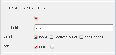

    Thanks for the reply. Could you plz clarify where then will captab analysis be useful? Does it give only node to node capacitance? Could you please also advise how to inlcude options like captab in the netlist and run the netlist in cadence. I tried including the .options into the netlist generated from the ADE but that is of no use and ADE over writes it when i run green button.
    So is there way to directly modify and run the neetlist?
    As per your advidse i will not use captab for determining total capcitance of each node.
    I also want to calculate propagation delay from input to output for example for a simple NAND cmos structure. Is there any direct means from teh GUI. If not what means do you suggest?
    regards
    Sorry about all the emails advising new posts - I was trying to clean up the mess caused by the fact that this had been appended to a completely unrelated post (which the forum guidelines explicitly ask you to avoid, as it means readers of the posts who are searching for things in future get horribly confused).
    There's no need to modify the run the netlist. It's in the UI in ADE from either the dc analysis or the tran analysis. You get to it via the Options button on the bottom of either form. For transient it's on the misc tab, on DC it's on the main options form. There's a checkbox for captab, and when you enable it, you get options to control the analysis statement directly and choose whether you get node, nodetonode, or nodetoground.
    The solution is slightly incorrect - actually nodetonode also gives you the total node capacitance as well as the individual pairs of nodes. nodetoground only tells you the capacitance to ground. The solution doesn't tell you not to use it - and I don't think Shawn did either. You just have to know how to interpret the results.
    Also, if you really didn't want to use the UI, there's no need to actually modify the netlist - put the captab info statement in an include file and reference it via a model file. Just create a file like you mentioned earlier, call it (say) "myanalyses.scs" and then use Setup->Model Libraries and then reference the file. But since you can do this from the UI easily enough, it doesn't seem worth it to me...
  • ShawnLogan
    ShawnLogan over 12 years ago
     Hi Andrew,
    Thank you for providing the detailed instructions! Your summary of my thoughts isexactly correct. I am not sure what specifically auto dipper is trying to determine and hence wanted to make sure he or she understood how to interpret the results of captab. I was not recommending auto dipper not perform a captab analysis.
    Thank you!
