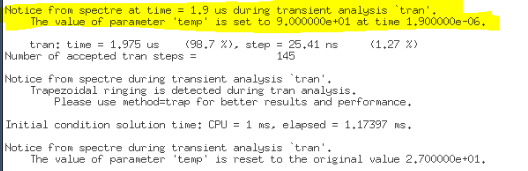

I just have a quick question on certain aspect of dynamic paramter on Virtuoso ADE. As you can see from the image, why does temperature reset to 27C after changing into 90C from 1900ns?
Here is another image with temperature setting for dynamic paramter:

    Something is a bit odd - because it has a message about initial condition solution time - near the end of the transient. So it looks as if it is doing more than one transient or something similar.
    Please can you post:
    1. The analysis statements and options at the bottom of the input.scs (Simulation->Netlist->Display) - everything from the bottom of the circuit to the end of the file. Please post the text rather than a picture (text is searchable, copy-and-pastable).
    2. Which subversion of spectre you're using (that will be at the top  of the spectre log file)

     ic net017=1V net018=0V net019=0V net020=0V
        checklimitdest=psf
    tran tran stop=2000n param=temp param_vec=[0n 27 1900n 90] \
        write="spectre.ic" writefinal="spectre.fc" annotate=status maxiters=5
    subckts info what=subckts  where=rawfile
    and I believe the subversion is:
    Cadence (R) Virtuoso (R) Spectre (R) Circuit Simulator
    Version 10.1.1.374.isr21 64bit
    Thank you very much,
    Sincerely,
    jjang3
    jjang3,
    OK, I've experimented with your setup, and all that is happening is that once the transient is completed, it's resetting the temperature back to the original value so that any analyses which run after the tran will use the normal temperature rather than whatever it ended up with in the transient. The transient itself will have completed by the time it resets the temperature.
