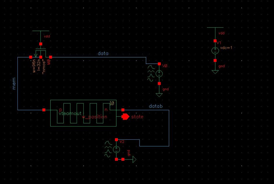

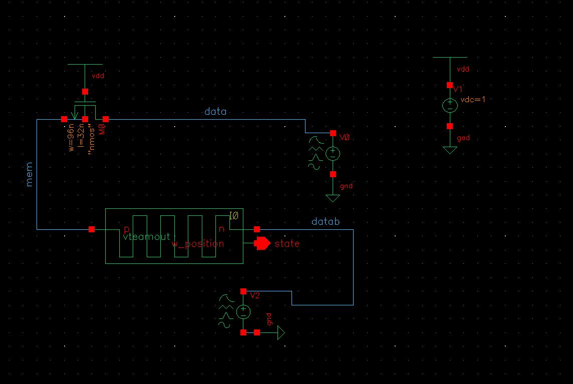

    eashwar g over 11 years ago
    with the circuit as shown in fig1 it simulates without errors

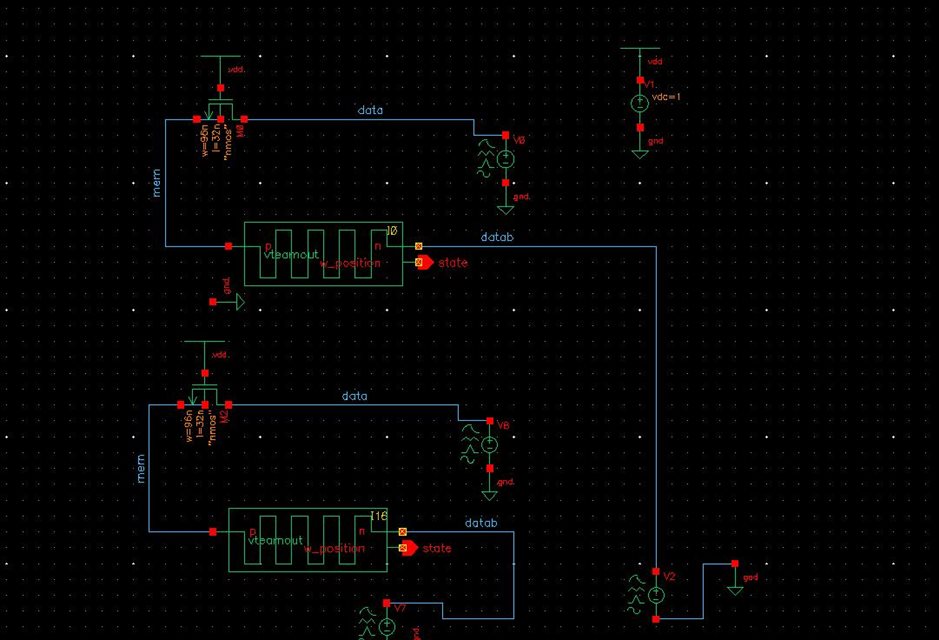

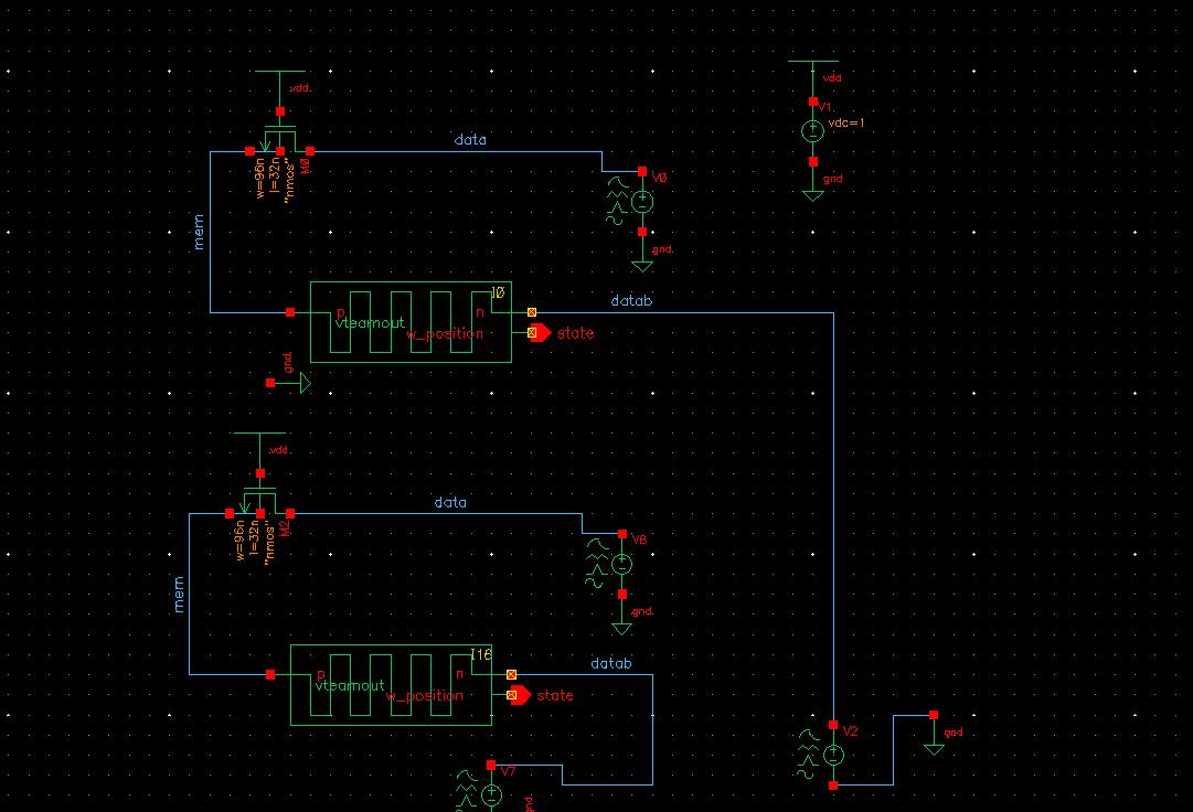

  • eashwar g
    in this fig ..i hav just used copied the above circuit ..so wen i start spectre simulation it says rigid loops error ..y is this happening with multiple circuits
    there is no connection between the 2 circuits ., then how come it starts up error .. please suggest some solution
  • Frank Wiedmann
    Frank Wiedmann over 11 years ago
    There are in fact many connections between the two circuits, because wires (and pins) labeled with the same name are connected.
    In addition to what Frank says, this message is telling you that you have multiple voltage (or potential) sources in parallel, and is a check that is done because there can be no solution to the equations in this case (think of having two ideal voltage sources with different potentials in parallel - what would the voltage across them actually be?)

    thank u frank and Andrew for your advice .,i need to use both the sources for that component so i need to put those two sources one is inverted and other is non inverted input .,As per my design i am supposed to use both so please suggest some solution to this problem if i create a component with 3 pins a,b,c and i use that component twice as shown in figure ....will there be any issues i mean the second component with pins a,b,c accepts the same voltage and current as that of the first component. i hope you understand what I am trying to convey.. regards eashwar
  • Frank Wiedmann
    Use different names for the wire labels (and the pins) in the two parts of the circuit.
