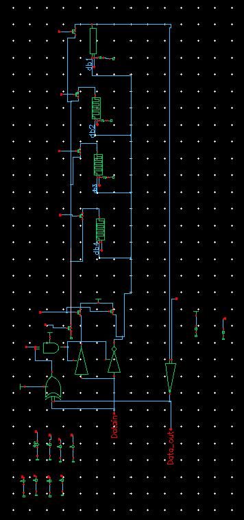

    but now i get this illegal bus reference number error Illegal bus reference - Can't tap "<db2>" from net "db1" i need to connect two pins to a same source say db1 and db2 to voltage bl ..so that depending on logic function either db1 or db2 will take the source
    Please can you read the forum guidelines. Your questions are rather assuming that we can see your design or read your mind...

    It's not really clear for me what you are trying to do; a schematic would be helpful. I also suggest that you study chapter 2 named "Understanding Connectivity and Naming Conventions" of the Virtuoso Schematic Editor L User Guide (also available at http://support.cadence.com/wps/mypoc/cos?uri=deeplinkmin:DocumentViewer;src=pubs;q=/comphelp/comphelp6.1.6/chap2.html).

    i have atached schematic below
    the db1,db2,db3 db4 as shown are connected to one node
    Since there are no labels visible on your picture, answering this is going to be rather hard...
    This might be about using the "patch" component (see the manuals that Frank mentioned), but I have no idea what you're trying to do.
    Maybe contacting customer support would be more efficient than sending partial bits of information back and forth.

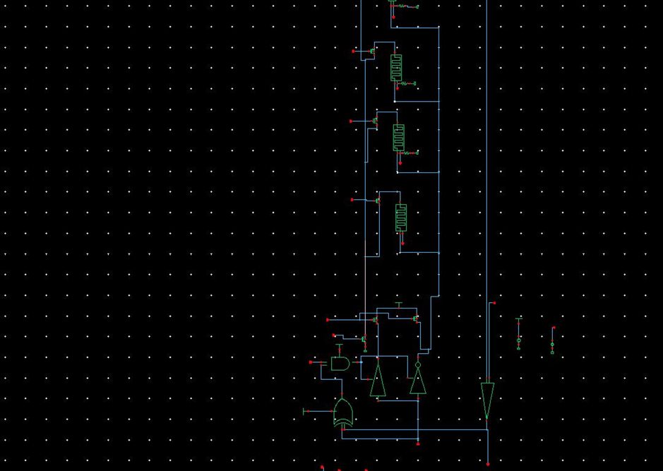

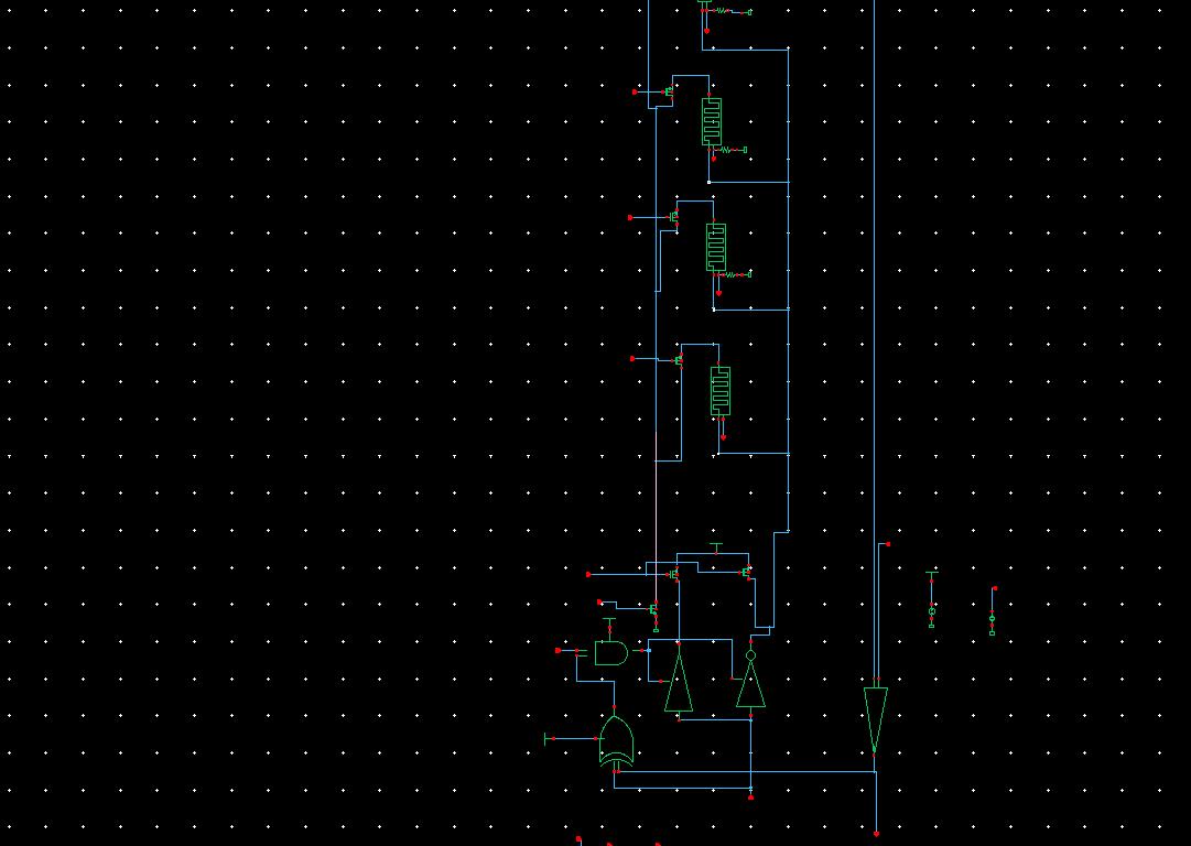

    i am reading the document .,meanwhile i have increased labels size ., check the schematic
  • Frank Wiedmann
    Frank Wiedmann over 11 years ago
    You can't give several different names to a single wire (without using some tricks, at least). Simply delete three of the four labels and your problem should be gone.
