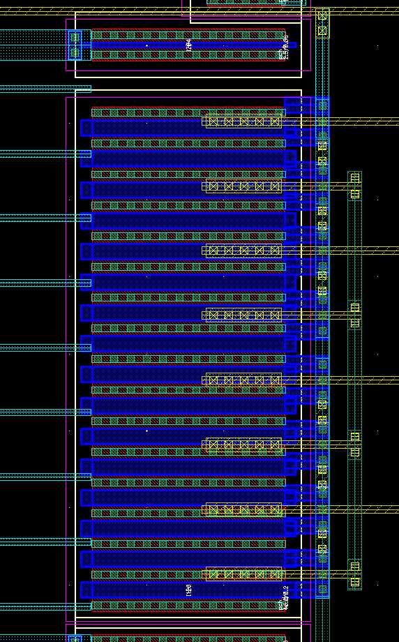

Hi all,
I am using TSMC65 (CNM65GP). I converted a design from CDB to OA using CDB to OA translator GUI provided by cadence.
virtuoso version is 6.1.3.
In the translated layout, I see the drawn paths/recs are shifted for some reason. It might be due to different scaling factors for the MOS and drawings. Any help on how to resolve this issue is greatly appreciated.
An example snapshot is attached.
Thanks in advance,
Siladitya
    My guess is that there is a difference between the PDK versions you're using - maybe there's a migration script to move from one to the other? Perhaps you can check with the foundry.

    I found out the root cause for the layout differences in CDB and OA.
    In CDB the transistors have  DFM_options set to DFM+Analog.
    When translated to OA and opened in IC6, the transistors shows DFM options set to minRule for both sch and lay. This leads to shrinking of transistors and thus apparent shift in layout.
    Is there any switch in cadence that will set the default DFM_options to DFM+Analog ?
    If you have any input on this, please let me know.
    Thanks for your support,
    Siladitya
    This is a PDK-specific default, and the difference is presumably different to a change in default value between the CDB and OA version of the PDK.
    Changing the default value in the CDF is unlikely to be enough, because if it doesn't match the pcell default, then you'll still have problems.
    Most likely you'd need to have some SKILL code to go over every instance and change the DFM options property. I cannot imagine you are the first to have this issue, so carefully check the PDK documentation to see if the foundry already provides such a utility, or if not, you should contact them. If you have no joy with that, please contact Cadence customer support where we should be able to assist you.

    The "TSMC PDK tool" in virtuoso has an option "switch DFM options". I had to change the default DFM option of the entire TSMC65 pdk(OA version) library to "DFM+Analog" and it resolved the issue.
    Thanks
