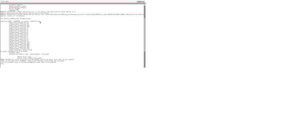

    Using CDL netlist for the standard cell library, and using  File->Import->SPICE ,
    We got error message as shown in snapshot .
    ERROR (SPICEIN-24): Spice In did not find the symbol view of the master cell 'nfet' of the instance
    'MN15' in the subcircuit 'AD42M2RA'. Specify the reference library that has the symbol
    view of the master cell, or use device-mapping to map 'nfet' to a different
    cell.
    We have also added symbol library as a reference library.
