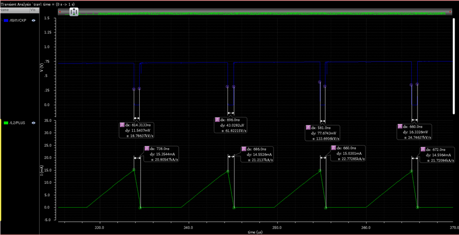

I have two signals as in the picture below.
I would like to measure some information and export them to a table or a file something like this:
Pulse width     fall time
614n                738n
696n                686n
581n                660n
660n                672n
I am wondering if there is a way to do that. It would be a great help. Otherwise, I have to do it manually with hundreds points.
Thank you.
    I think you could do this with the dutyCycle and fallTime functions in the calculator. Both allow you to generate the value versus cycle number. For the duty cycle, you'd need to divide by 100 and multiply by the period to get the actual pulse width. For fallTime, it normally does it 10 to 90% rather than peak to peak - mainly because the peak may not be precisely in the same place - so you could probably just measure the 10% to 90% fallTime and then multiply by 1.25 to get the peak to peak value?
    If you can generate both expressions in the calculator, you can then send each to a table (using the table button in the calculator) and then you'll have both sets of results.
    Something like that (I very quickly tried it out with some made up data and it seemed a reasonable approach). I'll leave the details to you as it will depend on your data and precisely what you're trying to measure.

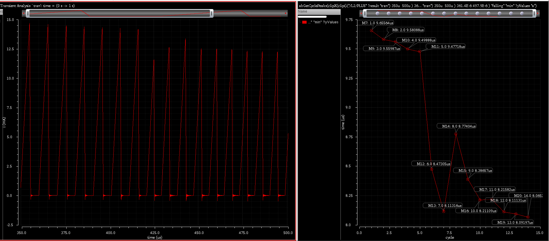

    I used dutycycle and it is OK. However, could you tell me how can I get the period of the signal versus cycle?
    You can use the freq function in the calculator (and then take 1/x of that). This allows you to compute the frequency versus cycle, and obviously the reciprocal is the period.
  • BaaB
    BaaB over 10 years ago
    Thanks.
    For the fall time, is there a function to find difference between the location where inductor current is maximum and the location where inductor current is zero versus cycle?
    I think your method works but because I need a high accuracy so hope there is a better method.
    Also, if I use fallTime function, I have to specify the initial and final value. The final value is 0 but the initial value is not a constant. That is what I am facing now.
    I'm part way through writing something that finds the local peaks and troughs in each cycle. It's not entirely trivial, so may need a bit more time before I've finished it (I'm doing it between other tasks).

    This code should do it. See the example in the comments. Making this flexible is what took a bit of time. It probably could do with a bit more testing:
    /* abGetCyclePeaks.il
    Author     A.D.Beckett
    Language   SKILL
    Date       Mar 23, 2016
    Modified
    By
    Function to calculate the peak values (or times of peak values)
    within each period. Has some tolerances built in so that it should
    detects when it first reaches the peak and filters out numerical
    noise.
    Example - measure fall time (peak to peak) in each period:
    abGetCyclePeaks(v("ramp" ?result 'tran) "rising" "max" ?yValues "x")-
        abGetCyclePeaks(v("ramp" ?result 'tran) "rising" "min" ?yValues "x")
    SCCS Info: @(#) abGetCyclePeaks.il 03/23/16.22:27:05 1.1

  • BaaB
    Thanks a lot for these help.
    I am just a beginner. Could you tell me how to run this code?
    Also if I want to write kind of this code, what language or something that I should learn?
    To use the code, you can use the load() function to load it. Put it in a file (abGetCyclePeaks.il) and then in the CIW:
    load("abGetCyclePeaks.il")
    You can put this line in your .cdsinit too (put the full path to the file if necessary).
    The code is written in SKILL - which is a LISP variant. In fact all your calculator expressions are SKILL too - so to actually use the function, you'd need to type the function call (as shown the comments) into the calculator buffer. It's possible to add it as a custom function in IC617 easily through the UI - I'll post how to do that a little later.

  • BaaB
    Thank you.
    I have just tried the function as the attached file. I don't know how to send the signal so I export it into excel files.
    Sorry, I couldn't attach the file here.
    1.Triangangle wave test execl file:
    http://www.filedropper.com/trianglewave
    2. Result in excel file:
    http://www.filedropper.com/outputfallingtime
    I can't explain how the result is 14 cycles here. Also because you use minimum value, the result is not accurate for calculating fall time here.
    In this case, it seems that the measured result is something like period.
    I am reading the code so hopefully I can modify it to measure the fall time between maximum value and the point where it crosses zero first time in each cycle.
