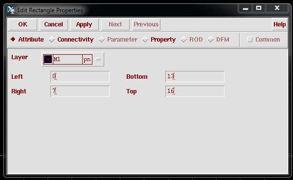

    Hi Andrew,
    thanks for the answer. I will try to give some more details.
    - to do DRC, LVS and Extraction: I open the layout with Virtuoso Layout and then I find everything under "Verify". DRC is using a file called divaDRC.rule, LVS is using divaLVS.rul and the Extractor is using divaEXT.rul...so, I assume I am using DIVA :)
    - the pins are located on M1 - pn. I attached two images here looking at their properties:
    There is only that "Net Status" option that seems a bit odd to me, but for the rest it looks like the net is recognized as being a global net with the correct name (the same applies for the gnd! net, which I didn't show here).
    Obviously, below this M1-pn layer, there is a M1-dg layer that draws the "physical" net.
    This is why I say that I don't understand the first proposed solution: to me it seems that the pin is already there.
    Thanks a lot for the help!
    Francesco
