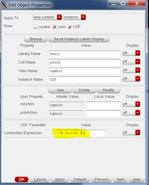

I am designing a circuit, where I need to connect a 32 bit wide bus to another bus which is 32 bits wide. I am trying to use a patch with the appropriate schPatchExpr, but I am not able to get the syntax right.
I tried the following
and get the following error
Error: Patch cord "I20" -270004): Illegal name syntax - Syntax error in connection expression.
If I try creating the patch with the following expression in schPatchExpr
I get the error
Error: (SCH-3489): Shorted terminals - memTerms 'address_lrc_ram<31>' & 'address_i<31>' thru signals 'address_lrc_ram<31>' & 'address_i<31>'
Could somebody help me with the syntax for the schPatchExpr so that I am able to connect all 32 bits of the bus correctly.
Thanks
Prashant
    Hi Prashant,
    It should be: 31:0=31:0 (don't have the angle brackets in the expression). The examples in the documentation make this pretty clear (search for "patch" and you'll find it).

    prashantpd over 8 years ago
    Hello Andrew,
    Thanks for the prompt reply. I however still get the following error
    The documentation is clear on this too (this is copied from the documentation):
    Note: Only one of the nets can be connected to a schematic pin (I/O pin). Also, in the schematic editor, you cannot connect an input pin to an output pin even though you use a patchcord in the middle.
    If you want to connect two pins together and rename them, the only way of doing this is to have a component in the way (such as basic/cds_thru, for example), You'd have to give the instance name of cds_thru I1<31:0> for example so that it has the same width as the bus. Note that cds_thru isn't a true short - it's designed for this kind of application though.
    Hello Andrew,
    It worked. Thank you for your help and sorry for not having read the documentation thoroughly.
