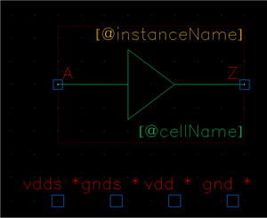

I am working on Virtuoso, version IC6.1.7-64b.500.4. I am using inherited connections in the schematic. AFter parasitic extraction, I observe that the inherited connections are missing in the netlist. I know that it is not recommended to use inherited netlist. Still, is it possible to have a work around so that with the inherited connections we can have a symbol with all the power\ground pins?

    Let me explain now the steps I followed. I drew a schematic where I used vdd_inherit, vdd1_inherit, gnd_inherit, gnds_inherit from STlib library. A symbol is generated from the schematic cellview, which I used in the testbench for the testing purpose.
    Once the circuit schematic is complete, I drew the layout. In the layout, I used explicit pins for the power rails. Once, the DRC and LVS results are clean, I went for extraction.
    The extracted netlist is used while running the same testbench. I selected the 'extracted' option in ADE for that. Now, I see the simulation result is way too far from the actual output. While debugging, I realised that the extracted netlist cannot find vdd, vdd1 and gnds.

    My final goal is to have a symbol where I will have all the inherited connections as pins, even if the inherited connections are used in the schematic. I have given the following example which I would like to achieve.
    Regards
    Saikat
