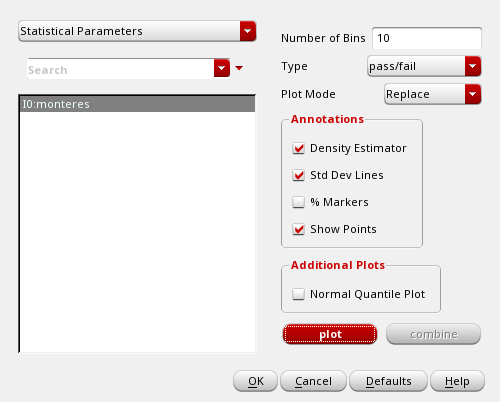

    I first misread what you wanted and so did some screengrabs on how to plot a histogram of the statistical parameters monteres. So I'll show that in case it's useful, then explain how to get a histogram of r_effective.
    Histogram of monteres
    So, first of all you need to save the mismatch parameters (since you're doing a mismatch simulation). Click the "gear" icon next to the Monte Carlo sampling mode (i.e. where you set the number of samples) and turn on saving of mismatch parameters:
    Then run the simulation. After running the simulation, you can use the histogram icon in the results pane:
    Then on the resulting form, pick statistical parameters and choose the instance and parameter:
