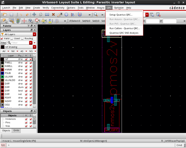

All is in the title. I can not run Quantus QRC because it greyed in QRC menu and don't know why.
Someone can help?

    Have you run LVS? If yes, which tool did you use? If you ran LVS using Assura, can you tell me the IC and Assura versions you are using.
    Saloni
  • manudupouy
    manudupouy over 8 years ago in reply to Saloni Chhabra
    Yes, LVS passed without any problem.
    I am using IC617, ASSURA41 and EXT172.

    Andrew Beckett over 8 years ago in reply to manudupouy
    Thanks for the additional data.
    OK, it is in fact because you're running on an unsupported OS.
    What's happening is that the message about this being an unsupported machine is being output before the qrc -v output, and because of this the version checking code doesn't ever see the qrc version number. When I first looked at this I thought that it was reading the entire output from the "qrc -v" command, but because the wrapper first outputs the unsupported platform before the main qrc executable prints the version, the problem occurs.
    I managed to try it on a CentOS machine, and see exactly the same problem.

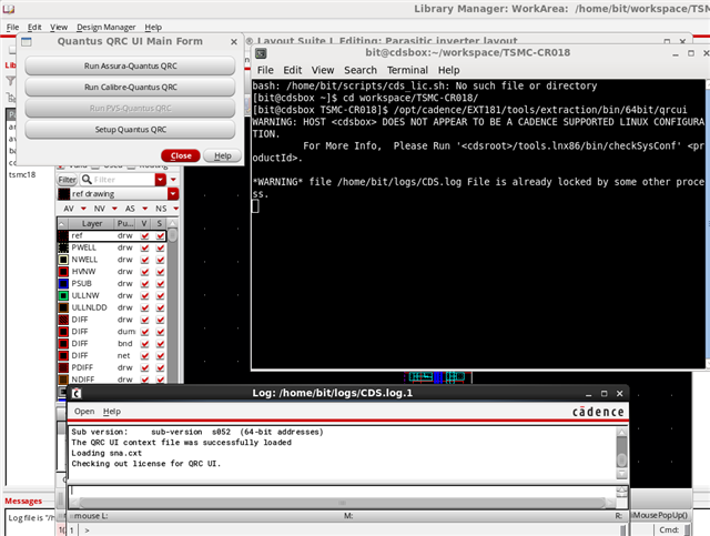

    Yes - use a supported OS!
    We do have an article which explains how to workaround this: When using (unsupported) CentOS, a new, frequent warning occurs since 617/123 ISR9. Can the warning be suppressed?
    Note that whilst that article does give an environment variable to suppress the message, it makes it very clear that this does not mean that CentOS is implicitly supported by doing this. It's at your own risk. Using the env var given does fix the problem though (I tried it).
    Andrew Beckett over 8 years ago in reply to Andrew Beckett
    This is one of the reasons we have supported OS platforms. Sometimes you spend a lot of time trying to get to the bottom of a problem on a platform that we don't test on (such as I did with this issue...)
