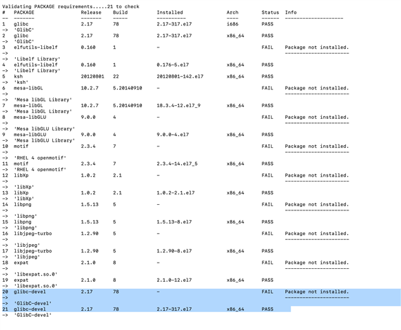

    Hi Andrew, we ran into similar issue. We are using IC617, ASSURA 415-617, OS is RHEL 7.9  (MaiPo)
    We can't find the QRC menu under the Assura. With the following setup in the cshrc file,
    setenv QRC_HOME /w/apps3/Cadence/EXT171
    set path = ($QRC_HOME/bin $path)
    we can find the Quantus in the Layout, but it keeps saying the Loading Quantus menu. And a warning shows up in the CIW
    *WARNING* QRC_HOME environmental variable is set but UI can't locate correct QRC installation.  In order to run UI in QRC compatibility mode you need to have QRC executables in your $PATH and QRC version should be 8.1 or greater.  Check your QRC installation and environmental settings.
    _vuiGetQRCVersion() returns 0
    qrc - v returns
    WARNING: HOST <eeapps01.seas.ucla.edu> DOES NOT APPEAR TO BE A CADENCE SUPPORTED LINUX CONFIGURATION.
                For More Info,    Please Run '<cdsroot>/tools.lnx86/bin/checkSysConf' <productId>.
     Name             : qrc - Quantus QRC - (64-bit)
     Description      : Quantus QRC Extraction program
     Version          : 17.1.1-s059
     Build Ref. No. : 059
     IR Build No.     : 059
     Build Date       : Thu Jun 22 18:17:15 PDT 2017
     Copyright 2017 Cadence Design Systems, Inc.
     All rights reserved.
     THIS PROGRAM IS CONFIDENTIAL AND PROPRIETARY
     TO CADENCE DESIGN SYSTEMS, INC. AND CONSTITUTES
     A VALUABLE TRADE SECRET.
     This work may not be copied, modified, re-published,
     uploaded, executed, or distributed in any way, in any
     medium, whether in whole or in part, without prior
     written permission from Cadence Design Systems, Inc.
    and the checkSysConf EXT17\.1 gives us
    What suppose we do now?
