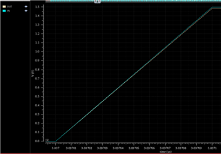

I am using an ideal delay cell in analoglib. With defined 1 ps delay, the cell is sometimes behaving abnormally with changed slopes. The smaller time strobe and max time step may solve this problem.
Is this error an systematic offset in the simulation or it would change with the simulation state ? And is this cell similar to the real CMOS transistor, which means that in the transient simulation, the  transistors may appear same artifacts in the simulation ?  And what would be a correct time strobe set for 1 ps delay ?
Thanks.

    Ruixin over 8 years ago
    The schematic is as above.
    Andrew Beckett over 8 years ago in reply to Ruixin
    It's not that clear to me what you're doing. Can you provide the netlist (input.scs) for the different configurations you are simulating? Since I can't see the simulation setup nor all the parameters from the schematic, the input.scs would be much easier.
    Fundamentally this is because the delay line does not force output time steps. You get time steps at places defined by the input source (the simulator places breakpoints at the transitions to ensure the simulator simulates there), but the output changes when there's a timestep. If you look at the time steps by turning the symbols on the traces, you'll see that there's no time step until a reasonable time (certainly more than 1ps - it's something like 200ps for the top edges, and 25ps at the bottom edges). Bear in mind that the lines on the graph are just joining the simulated points - it's the points which are controlled for accuracy, not the lines.
    This isn't necessarily inaccuracy - it's just that the simulator has not bothered to take what it deems as unnecessary time points in the simulator. If the circuit is active enough, it will follow the transitions with sufficient accuracy.
    In this trivial case (I assume net07 was supposed to be grounded or this was a sub-part of the real netlist), you could force a timestep 1ps after each transition by adding a second source (I just modified V0 above) with the same parameters as V10 but with delay=1p (you can check the time points with symbols=On again).
    As for the correct strobe set up for DFT, I can't say without knowing what you are hoping to use in your DFT... . By the way, maxstep is never the right way to control timesteps for a DFT; strobeperiod might be, but it depends on what you're really trying to do.

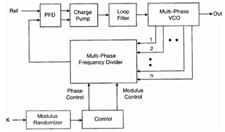

    Ruixin over 8 years ago in reply to Andrew Beckett
    Hi, Andrew,
    The block diagram may seem to be like this
    The multi-phase vco feedback one of the phases sequentially every reference cycle back into PFD, and I measure the PLL's output. I am not sure the setup for the time strobe to estimate the spur.
    Sincerely,
    Ruixin
