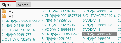

I'm trying to probe some internal signal nodes of an RC extracted circuit, searching for root cause of a DC  offset.
The simulation is a simple dcOp from ADE-L on a test bench defined by hierarchy editor.
Results-->Print-->DC node voltages  will indeed print the voltage on any node but only as long as that node coincides with a pin.
Any of the other intermediate nodes (separated by presistors)  are selectable and get highlighted but only produce a question mark.
Also the result browser does not get me any further.
I'm sure the simulator computed the all the internal node voltages, but how get them out?
I tried Outputs-->Save All-->Select signals to output(save)="all" and various settings for "subcktprobelvl"
Also in QRC played with net_name_space = "SCHEMATIC" iso "LAYOUT". Does not make any difference.
Cadence-ic-/06.17.717.

    For step "b", I meant doing the simulation using a config view. I should written "extracted view linked to config view". You are trying to probe the voltage/current of the parasitic resistors. This cannot be done by the out-of-context probing which only probes RLCK values. The results browser should actually have the info. E.g.
    Rj1 (IN \8\:IN) resistor r=0.9789 l=1.305e-06 w=8e-08 tc1=0 tc2=0 c=0
    The node voltage for parasitic res Rj1 can be found in the results browser. Is your results browser not showing the info?
    Best regards
