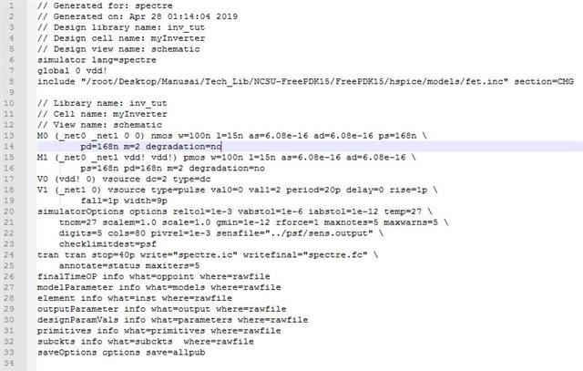

    Chandu D over 7 years ago in reply to Andrew Beckett
    We did not make any changes other than changing nfet/pfet to nmos/pmos. The following is the input.scs
    Andrew Beckett over 7 years ago in reply to Chandu D
    Sending a screenshot of the netlist isn't terribly helpful - I'm not going to type it in again to test it!
    ohk sorry. Here is the input.scs
    // Generated for: spectre
    // Generated on: Apr 28 01:14:04 2019
    // Design library name: inv_tut
    // Design cell name: myInverter
    simulator lang=spectre
    global 0 vdd!
    include "/root/Desktop/Manusai/Tech_Lib/NCSU-FreePDK15/FreePDK15/hspice/models/fet.inc" section=CMG
    // Library name: inv_tut
    // Cell name: myInverter
    // View name: schematic
    M0 (_net0 _net1 0 0) nmos w=100n l=15n as=6.08e-16 ad=6.08e-16 ps=168n \
    pd=168n m=2 degradation=no
    M1 (_net0 _net1 vdd! vdd!) pmos w=100n l=15n as=6.08e-16 ad=6.08e-16 \
    ps=168n pd=168n m=2 degradation=no
    V0 (vdd! 0) vsource dc=2 type=dc
    V1 (_net1 0) vsource type=pulse val0=0 val1=2 period=20p delay=0 rise=1p \
    fall=1p width=9p
    checklimitdest=psf
    tran tran stop=40p write="spectre.ic" writefinal="spectre.fc" \
    annotate=status maxiters=5
    We tried with smaller voltages of vdc (1.2V and 800mV) but are still getting blowup. can you tell me what did you set your values for vpulse?
    I'm guessing that you set the DC supply to 1.2V but left the pulse source at 2V. That's not a good idea... you don't want your pulse source exceeding the supply voltage. Set the high voltage of the pulse to match your DC supply (in ADE probably a good idea to create a design variable and set both sources to use the same variable.
    If you have a supply of 1.2V and a pulse peak of 2V, the blowup occurs during the transient when the pulse source goes high.
    Blowups are fairly rare in spectre and is usually an indication of poorly characterised models (I suspect they have non-physical behaviour outside a certain voltage range).
