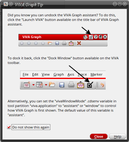

I'm running IC6.1.7.500.22.
I like to know if it is possible to de-activate the popup window of the VIVA Graph tip (see image) every time I start ADE Assembler/Explorer and run a simulation. Even though I have select the Do not show this again, it keeps coming up in new sessions!
thanks in advance.
best regards,
    Normally if you check the “Do not show this again” it writes a line into ~/.cdsenv :
    maestro.plotting showViVAGraphLaunchTip boolean nil
    So check that this is happening. It may be that you have something else in your environment which is setting this cdsenv after the home ~/.cdsenv has been read in, or it may be that you have things configured to never read a ~/.cdsenv (although that would be unusual).
    Check in the CIW (in a fresh virtuoso - having checked that the entry is in the ~/.cdsenv as described above):
    envGetVal("maestro.plotting" "showViVAGraphLaunchTip")
    You might also want to check what $CDS_LOAD_ENV is set to in the terminal, and also what “cdswhich -lookupconfig .cdsenv” returns and then “cdswhich -all .cdsenv” returns.
    Thanks,
  • Noca
    Noca over 7 years ago in reply to Andrew Beckett
    Hi, Andrew.
    thanks for the reply. I found the problem in the .cdsenv file, which had wrong file permissions. After I corrected it, everything is fine.
