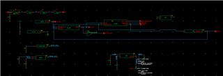

    My top cell schematic Testbench is as below:-
    It has the bpd cell aslo the verilog, verilogAMS cells.
    It runs fine in AMS simulation without bpd cell. The bpd cell has beh view in config.
