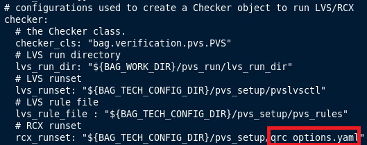

    I would like to ask if you confront with the problem that there are no "qrc_options.yaml" file while extracting RC via BAG.
    As I use GUI  to extract, there are no problems. Therefore, I went to see bag_config.yaml to check what is going on. I found that there aren't existing "qrc_options.yaml"
    I use the same pdk(cds_ff_mpt) as you.

    As for this file, I have already consulted with the maintainer of BAG, and he left a message as showed in the following picture.
    He said since Cadence doesn't provide the extraction flow of the cds_ff_mpt; therefore, it is hard to set up "qrc_options.yaml", which is the artifact file written in python to let the BAG system run RC extraction automatically.
    Could I ask about which PDK has provided the supported extraction flow?  Or which file is the "extraction flow" of the cds_ff_mpt downloaded from http://pdk.cadence.com.

    Andrew Beckett over 6 years ago in reply to Danielrayray
    Hi Daniel,
    I suspect the maintainer of BAG is talking about an old version of cds_ff_mpt. The 0.3 version didn't have Quantus QRC rules, but the 0.5 version (which is the currently available version on http://pdk.cadence.com )  does  have Quantus QRC rules set up:
