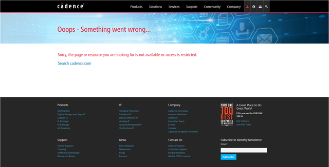

    By the way, The document you thankfully gave to me ( Session CUS12 : Using Virtuoso® ADEGXL Circuit Optimiser to Reduce Time-to-Market for Complex Analog Circuit Design in 40nm)is not valid any more, nor I can find it in the internet, can you please send me again ?
    Andrew Beckett over 6 years ago in reply to NorNand
    The link still works - perhaps it was a temporary problem?
    I may not have time to answer the other questions before I go on vacation tomorrow evening though...
  • NorNand
    NorNand over 6 years ago in reply to Andrew Beckett
    Thank you Andrew,
    The link worked one time and stopped working , it will be very helpful if you could please attach it here as a pdf as I am sure it has very useful information. This is the error I am getting by website
    I wish you a nice vacation and pleasant time
    I cannot attach it here, as it needs to be tracked as part of the CDNLive proceedings part of the site.
    The issue is that you need to use a login with an email account associated with the organisation you work for, rather than a non-specific email account such as gmail, hotmail etc.
