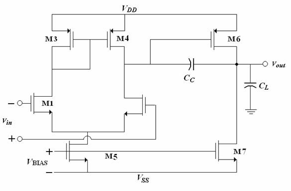

I am running the Circuit optimization from ADE GXL, I am practising simple two-stage operational amplifier as it has shown below,
I want to include a formula in my output setup the M6 drain current is near or equal to M7 drain current. This condition for the optimizer will assure that my circuit will have a very small offset voltage.
It is very basic to bring both currents to the output setup but I don't know how to make this expression formula between them,
Thank you

    I made indirect solution by taking abs(IM6-IM7) then I push this to ADE and select minimize to zero as a design target specification
