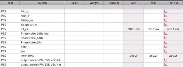

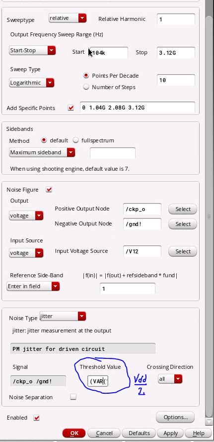

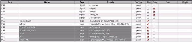

    1. pnoise frequency "limits": not sure to understand but I simulate between the offset frequencies 104kHz to 3.12GHz, and compute my integration between 104kHz and 1.04GHz.
    2. My clock is at f0=2.08GHz
    You can find attached the screenshots of respectively my pnoise/time average settings, and the formulas I use in ADE-XL to extract the "wrong" RMS jitter value of 269.2fs (compared to pnoise/jitter analysis value = 594.4fs.)

    I noticed you are using the pn() function in your expression "PhaseNoise_LdBc". That is not the function I use to compute SSB L(f) following a pnoise analysis. The function I believe you should use is:
    rfOutputNoise("dBc/Hz" ?result "pnoise" ?noiseConvention "SSB")
    This will assure that your phase noise curve is expressed in "dBc/Hz" and conforms to the L(f) IEEE definition. Have you tried using that function? The definition of the pn() function, from the ocean reference manual, follows. This function is used in a transient analysis. As a result, I'm thinking your expression for the integrated phase noise is not quite what you want.

    Thanks Shwawn,
    Actually the rfOutputNoise and pn functions give me exactly the same waveform, as a result I still get the same "wrong" jitter result of 269.2fs ...

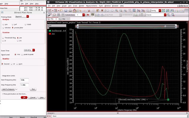

    I have noticed that the Jee waveform given by the "jitter" analysis is not the same as the "Jee" I have computed with the "time average" function; I think this is a first hint, see:

    Could it be my "jitter" settings that are incorrect (pessimistic)? I am using a "Vdd/2" threshold in that case
