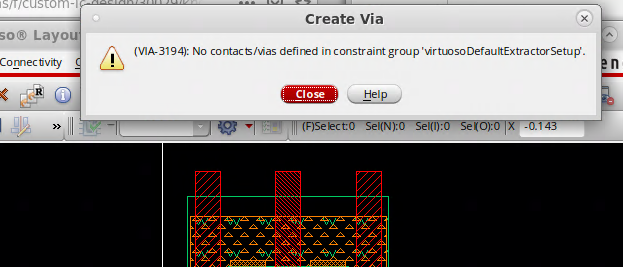

Hi, dear all,
I am trying to develop a library using FreePDK15 open cell library. But currently I can not create any vias in the layout editor and error pops up as follows when I try to add any vias.
The error is the same for all other constraint groups.
I found a file called "FreePDK.tf" which contains a section like this.
Are the sections standardViaDefs and customViaDefs useful? Do I have to define my own vias here? If yes, I am confused by the required inputs like "LibName" "CellName" and "resistancePerCut" so I hope someone can guide me through what should I fill for them. If not, can anyone help me find a way to define vias in the constraint group? Thanks a lot in advance!

    Hi Greeny,
    This PDK is pretty primitive and has lots of stuff missing. It seems to have quite a lot of fixed cells for vias in the NCSU_TechLib_FreePDK15 library, but these aren't parameterised. You could add these to the customViaDefs - e.g.
    (MINT3_MINT2 NCSU_TechLib_FreePDK15 MINT3_MINT2 layout MINT2 MINT3 0.0)
    (MINT4_MINT3 NCSU_TechLib_FreePDK15 MINT4_MINT3 layout MINT3 MINT4 0.0)
    but this will be a bit rubbish because they are not parameterised. I'd suggest it would be better to fill in the stdViaDefs based on the relevant rules for those vias (I didn't spend time trying to figure out what is appropriate).
    You'd then want to add a validVias rule into the virtuosoDefaultExtractorSetup constraint group in the tech file so that it knows which vias to use.
    Or you could contact whoever maintains this Free PDK.

    Andrew Beckett over 6 years ago in reply to Greeny
    I've no idea why you posted the same question again separately since this was clearly part of the same issue you had before. Please don't do this - the forum guidelines ask you not to (it just irritates people). So I joined it to the same thread.
    Anyway, the technology database is in the NCSU_TechLib_FreePDK15 library, and is a binary file called tech.db. This was created from the FreePDK.tf that you asked about earlier - it's in the cdslib/setup dir (from memory - I don't have my work computer handy to check). That FreePDK.tf has the constraint group virtuosoDefaultExtractorSetup defined within the tech file.
    If you are going to try to fix this yourself, you'd modify the file (or a copy of it) and then use Tools->Technology File Manager and then load the ASCII tech file you've created into the NCSU_TechLib_FreePDK15 to update the tech.db in that library (don't forget to use the Save button on the Technology FIle Manager afterwards to ensure it gets saved before you quit Virtuoso).
