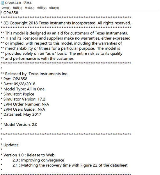

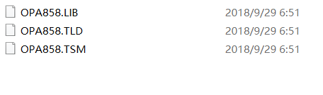

I want to import some Ti opamp models to virtuoso.  (.lib &pspice model)  .
Anybody know how to do that?  If you know, could you tell me the detailed method?
