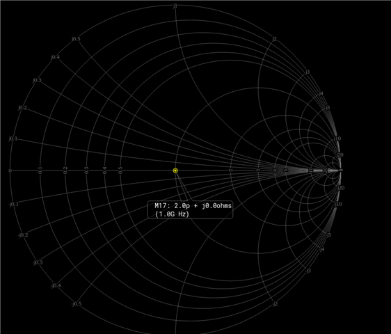

I'm running an .sp analysis with a simple setup--port set to 100ohm, with 100ohm load.  I'm plotting results on a Z-Smith, which i thought should give me Re(Z)=1 (normalized)... but instead I'm getting something like 2e-12 as the prime center.  I don't understand why this is the case.  I'm relatively new to Smith charts, but I'm guessing the plot actually shows reflection coefficient, not the impedance?  If this is the case, how can I request an impedance plot?
I'm on version 6.1.8.
Many thanks in advance for your help,
David

    Hi dzakharian,
    It seems good to me. You have a 100 Ohm reference system loaded with 100 Ohm. No reflection, so S11=0. The 2p is probably numerical error. 2e-15 is very good accuracy!
    The Z- and Y-Smiths returns the same reflection coefficient plane, just with different grids. Clearly this is not how one works with Smith charts on paper, but once the server does all the calculations it is great, or even better.

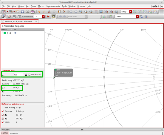

  • ZoltanT
    ZoltanT over 6 years ago in reply to dzakharian
    It is also there.
    Read impedance under cursor from Smith chart

  • dzakharian
    dzakharian over 6 years ago in reply to ZoltanT
    Hi Zoltan,
    Thanks for pointing this out!  Exactly what I wanted.  Do you know if there is a way to extract Z and Y values in the Tracking Info using calculator functions?
