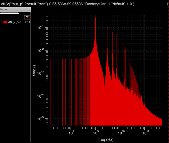

    If you are interested in just what the spectrum looks like, I would think a transient noise simulation will provide a plot similar to your figure titled "Out noise due to n1". I performed a transient noise simulation using a noise bandwidth of 500 MHz and a 1 GHz square wave feeding an inverter. I used a strobepoint of my maximum integration step (1 ps), and performed a 65.536 ns simulation to allow for a 65536 point dft without interpolation. The attached plot of the DFT of the output shows the noise spectrum folded about each harmonic of the 1 GHz input frequency. Is this close to what you were hoping to show?

    In your simulation however the skirts around the harmonics I believe are due not to flicker noise but to the fact that you’re not taking an integer number of 1GHz-periods inside your 0-65.536ns window. I retried similar simulations and these are the results that I get. The circuit is an inverter driven with the squarewave and the transient noise is performed with Noise Fmax=100M and Noise Fmin=100k. Input frequency is always 1GHz.
    The output waveform transform is calculated with rectangular windowing from 10ns to 100ns (90 periods) with 65.536k bins (yellow).
    The comparison with the same DFT but in a noiseless transient simulation (blue) shows the 100k-100M noise placed around every harmonics.
    You are absolutely correct! The dft of the noise sidebands is corrupted by the presence of spectral leakage due to my choice of dft period and input frequency period - I should have realized that of course. IN any case, I corrected the input frequency to be 1/64 of the dft sample time. I also thought you might be interested in the impact of the noise bandwidth on the spectrum. The attached plot shows the impact of setting the noise bandwidth to 200 MHz (for an input tone close to 1 GHz) and 500 MHz. It is evident that the added aliasing in the dft of the 500 MHz band limited noise tends to obscure the skirts of the 200 MHz noise characteristic about the harmonics of the input frequency.
    In any case, thank you for the aded analysis on your part, and I was happy to read that the transient noise provides something close to what you were hoping to view.
