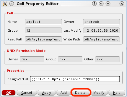

    You shouldn't remove the entire cell property bag as there may be other important properties in there (e.g. CDF is stored in the same bag). Instead, you want to delete the designVarList cell property.
    So, go over the cell name (for whatever your test bench schematic is called) in the library manager, and use Right Mouse->Properties. You should see a form like this:
    Click within the box that says the value for the designVarList (e.g. the black highlighted region above) and then click on the Delete button and OK.
  • sjwprc
    sjwprc over 6 years ago in reply to Andrew Beckett
    Thanks, Andrew, it works well now.
