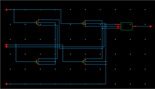

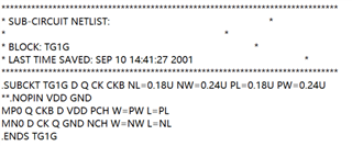

HI everyone,
I imported a standard cell library with spiceIn, and got many schematics corrosponding to defferent symbols.(device map: W w L l)
The cdl file contains some sub-circuits with parameters, as the first figure shows.
The circuits containing these sub-circuits are thus converted into schematics with symbols of corrresponding circuits, as the second figure shows
the sizes of the mosfets in the symbol circuit are correctly recorded in the cdf parameters of the symbol, as the next figure shows.
I tried to use these schematics for simulation ,but I need to set some parameter in ADE to make the circuit work.
The problem is that there are more than one symbols with the same four parameters "PW","PL","NW","NL", but the values are different. I can only set four parameter valuse in the ADE, thus setting all the symbols in the same way, which is wrong.
so how can I set all the sizes correctly during simulation?Or did I imported the cdl netlist in a wrong way?Aanyone can  help me with this? Thanks in advance!

  • ShawnLogan
    ShawnLogan over 6 years ago in reply to Skywalker121
    Dear Skywalker121,
    I may understand your concern - and if so I apologize - but it seems you can set a unique numeric value to each of the four parameters for each subcircuit. If you would rather not set a numeric value to each, you can enter a new variable name. The variable can be used in your Assembler or Explorer simulations. Of course, a different set of 4 variables is required for each subcircuit if you wish each to be unique values. The fact that the CDF parameter names is the same for each symbol is not an issue and should not prevent you from setting the parameter differently between subcircuit instances.
    Does this make sense? as a means to check this, you can create a netlist from your schematic. The CDF parameter names will not show up in your list of parameters at the beginning of your input.scs.

  • Skywalker121
    Skywalker121 over 6 years ago in reply to ShawnLogan
    Dear ShawnLogan
    I created a netlist as u said, but the CDF parameter names showed up at the beginning of input.scs file. I dont know what is going on here...   :(
    // Generated for: spectre

    Andrew Beckett over 6 years ago in reply to Skywalker121
    The issue is that SPICEIN doesn't handle parameterised blocks using the ADE/CDF way of parameter passing - it uses the older "NLP" parameter passing. This then doesn't work if you use ADE to netlist instances of the block. Cadence Change Request (CCR) 817161 is asking for this enhancement, but it's not been implemented yet.
    In response to this, I wrote some SKILL code to try to deal with it and convert the passed parameters into pPar expressions instead. I'm not sure how robust this code is, but it's been tried on a  few different examples (by other AEs too). So you might find this useful. It also requires abInvokeCdfCallbacks.il which you can find in this post.
    To use it, see the comments at the top of the code.
