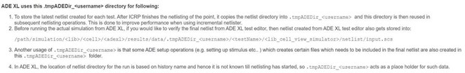

.tmpADEDir folder is used for unknown reason in Virtuoso, the path is so long
monglebest
monglebest over 6 years ago
I use Virtuoso IC6.1.8-64b.500.11.
The problem I have is that all the netlist/log files are generated under a
/home/data/ZZZ_simulation/cXXXXX/YYYTBLib/sim_tx_idac_veriloga_1000BT1_v9_config/maestro/results/maestro/.tmpADEDir_cXXXXX/dc_spectre/simulation/YYYTBLib/sim_tx_idac_wakeup_power_seq_v2/adexl/results/data/Interactive.1/1/PowerWakeUp/netlist/input.scs
This path is so long and also the test bench I am working with is sim_tx_idac_wakeup_power_seq_v2, not sim_tx_idac_veriloga_1000BT1_v9_config.
Making the path name under another test bench is very confusing, what's the method to modify this strange default behavior?

    I moved this into a more sensible forum (it's a technical question about Custom IC Design tools, not feedback questions or suggestions about the forum infrastructure). This looks like some contamination…
    This looks like some contamination between ADE XL and ADE Assembler/Explorer - I've not seen this happen. I did a very quick search and didn't find any similar reports (but I didn't spend that long searching, I'm afraid). You should definitely report this to customer support.
