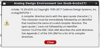

Dear All,
I have a verilog code portion as below:-
But, when I run I get error as :- ncvlog: *E,EXPCPD ... expecting a valid compiler directive [16(IEEE)]. `#if $NUM_STAGES$ > 2.
Could any body please tell how to fix this issue.

    Belated reply (was a bit busy at the time), but `#if (or indeed `#anything) is not a legal directive in Verilog. No idea why you think it would be - it's not in the IEEE 1364 Language Reference Manual (LRM). There are a number of them which are specified in Clause 19 of the 1364-2001 IEEE standard, but there's no `if (only `ifdef).
    I assume you got this from somewhere - perhaps it was a non-standard extension in a specific simulator?
