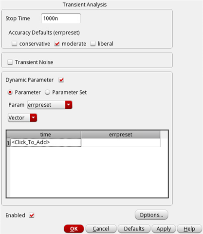

  • TaoC
    TaoC over 5 years ago in reply to ShawnLogan
    Thank you Shawn! This is exactly what I need. In the ADE gui, I also found this dynamic parameter option. But it seems that I can only select the param vector. Is it possible to add subcircuit in the ADE GUI window?
  • ShawnLogan
    ShawnLogan over 5 years ago in reply to TaoC
    Dear TaoC,
    I am happy to read I understood your question!
    I think you might use the additional parameter entry box in the Misc tab of the transient analysis panel I've highlighted in Figure 1 to include the syntax shown in the  reference manual. To verify this, create a netlist and verify that the transient analysis command contains both the errpreset value you desired and the "sub=" you entered in the additional parameter box. I dud not try this, so that is why I am recommending you verify it provides the proper syntax in the input.scs file.
    Shawn
