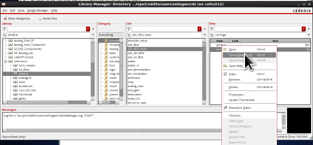

    There are a few ways to view the code. Two are included below to hopefully help you.
    1. As shown in Figure 1, you may open the  veriloga code for read from the library manager.
    2. If you have instantiated the symbol for the component in a schematic, you can descend into its veriloga view directly by doing a bindkey "e"' and selecting its veriloga view.
    Do either or both of these help?
    Shawn
    Figure 1
  • Mostafa A
    Mostafa A over 5 years ago in reply to ShawnLogan
    Thanks a lot dear Shawn,
    The first way did not work me because I don't have "verilog" in "view" part. I only have "symbol (I don't know why)
    But doesn't matter because the second way worked.
    Thanks
    Mostafa
  • ShawnLogan
    ShawnLogan over 5 years ago in reply to Mostafa A
    Dear Mostafa,
    Hmmm...the veriloga view must be accessible or you would not be able to simulate the circuit containing the instantiation. Might the view in the Library Manager be hidden?
