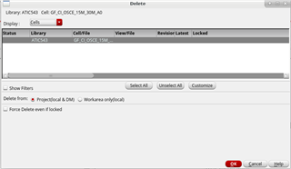

    since we have Cliosoft SOS installed, it looks like this if I right-click delete:
    I cannot select multiple cells.
    But I found now, that I have to use the "SOS Lib Manager" which is found in the "DesignManager" menu. There I can select and delete multiple cells.
    Problem solved.
